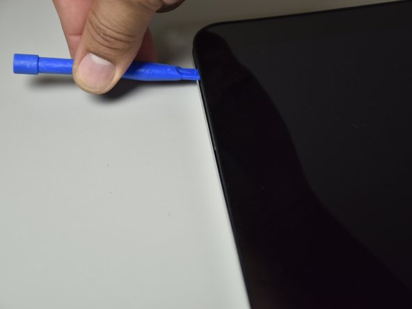

  9. HP Envy x360 m6-aq103dx Display Replacement: crwdns2935265:09crwdnd2935265:01crwdnd2935265:02crwdne2935265:0 HP Envy x360 m6-aq103dx Display Replacement: crwdns2935265:09crwdnd2935265:02crwdnd2935265:02crwdne2935265:0
    • Wedge the small plastic opening tool between the frame and the screen and pry it open by lifting up.
  10. HP Envy x360 m6-aq103dx Display Replacement: crwdns2935265:010crwdnd2935265:01crwdnd2935265:02crwdne2935265:0 HP Envy x360 m6-aq103dx Display Replacement: crwdns2935265:010crwdnd2935265:02crwdnd2935265:02crwdne2935265:0
    • Slide the tool around the edge of the frame while pulling on the suction cup.
    • Popping sounds are ok.

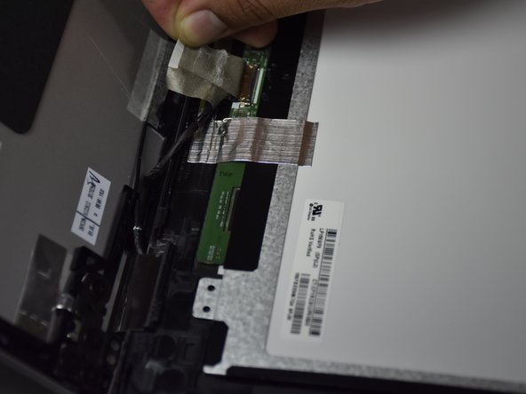

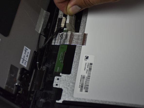

    • Remove the grey tape covering the wires by pulling on the tab slowly (located at the bottom of the display.
    • Detach the grey tape and the clear tape by wedging the small blue opening tool under the tape enough to raise a corner and pull the tape off with your hand.
    • Remove the tape slowly to avoid separating the adhesive.
    • Do this for both pieces of tape that cover wires.
  13. HP Envy x360 m6-aq103dx Display Replacement: crwdns2935265:013crwdnd2935265:01crwdnd2935265:03crwdne2935265:0 HP Envy x360 m6-aq103dx Display Replacement: crwdns2935265:013crwdnd2935265:02crwdnd2935265:03crwdne2935265:0 HP Envy x360 m6-aq103dx Display Replacement: crwdns2935265:013crwdnd2935265:03crwdnd2935265:03crwdne2935265:0
    • For the round cable underneath the smaller of the two pieces of tape, remove the cable by sliding it backwards.
    • Remove the other cable by pulling on the tape downwards and backwards.

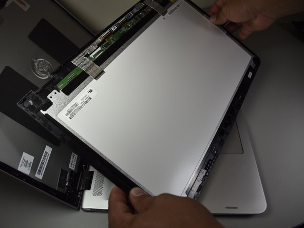

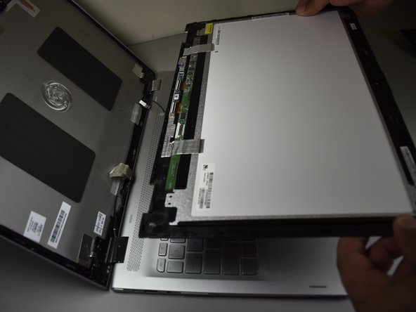

  14. HP Envy x360 m6-aq103dx Display Replacement: crwdns2935265:014crwdnd2935265:01crwdnd2935265:03crwdne2935265:0 HP Envy x360 m6-aq103dx Display Replacement: crwdns2935265:014crwdnd2935265:02crwdnd2935265:03crwdne2935265:0 HP Envy x360 m6-aq103dx Display Replacement: crwdns2935265:014crwdnd2935265:03crwdnd2935265:03crwdne2935265:0
    • Lift the screen up with your hands.
