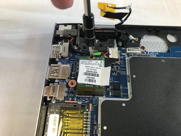

  5. HP Envy x360 m6-aq005dx WiFi Replacement: crwdns2935265:05crwdnd2935265:01crwdnd2935265:01crwdne2935265:0
    • Use the plastic opening tool to disconnect Disconnect the two cables attached to the wifi
  6. HP Envy x360 m6-aq005dx WiFi Replacement: crwdns2935265:06crwdnd2935265:01crwdnd2935265:02crwdne2935265:0 HP Envy x360 m6-aq005dx WiFi Replacement: crwdns2935265:06crwdnd2935265:02crwdnd2935265:02crwdne2935265:0
    • Use a PH0 tool bit to remove the one 2.8mm screw.
