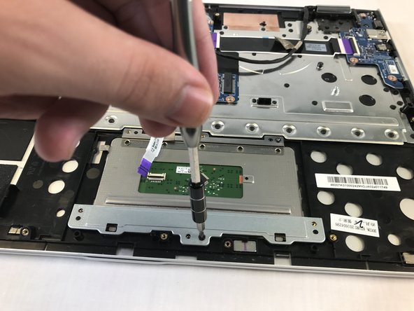

  6. HP Envy x360 m6-aq005dx Touchpad Replacement, Touchpad: crwdns2935265:06crwdnd2935265:01crwdnd2935265:01crwdne2935265:0
    • Carefully, pull back the locking clip of the connector using a plastic opening tool and disconnect cable.
  7. HP Envy x360 m6-aq005dx Touchpad Replacement: crwdns2935265:07crwdnd2935265:01crwdnd2935265:02crwdne2935265:0 HP Envy x360 m6-aq005dx Touchpad Replacement: crwdns2935265:07crwdnd2935265:02crwdnd2935265:02crwdne2935265:0
    • The red square contains two screws side by side.
    • Using a PH0 bit remove the 7 (2.8 mm) screws securing the touchpad to the device.
  8. HP Envy x360 m6-aq005dx Touchpad Replacement: crwdns2935265:08crwdnd2935265:01crwdnd2935265:02crwdne2935265:0 HP Envy x360 m6-aq005dx Touchpad Replacement: crwdns2935265:08crwdnd2935265:02crwdnd2935265:02crwdne2935265:0
    • Keep the ribbon cable from interfering with touchpad removal.
    • Use a plastic opening tool to pry up the touchpad.
    • Gently, pull out the touchpad from device.
