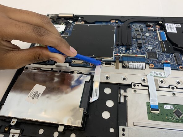

  6. HP Envy x360 m6-aq003dx Hard Drive Replacement, Hard Drive: crwdns2935265:06crwdnd2935265:01crwdnd2935265:02crwdne2935265:0 HP Envy x360 m6-aq003dx Hard Drive Replacement, Hard Drive: crwdns2935265:06crwdnd2935265:02crwdnd2935265:02crwdne2935265:0
    • Disconnect the ribbon cable by flipping the black tab with the plastic opening tool.
    • Gently pull the ribbon cable away from the connector with your fingers.
  7. HP Envy x360 m6-aq003dx Hard Drive Replacement: crwdns2935265:07crwdnd2935265:01crwdnd2935265:01crwdne2935265:0
    • Remove the two screws (5mm) using the Phillip's head #1 screwdriver.
    • Unplug the hard drive from the motherboard and remove it from the device.
