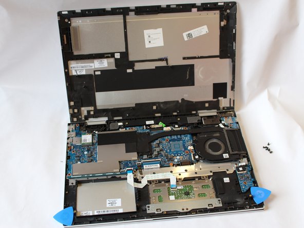

  3. HP Envy x360 15m-cn0012dx TrackPad Replacement: crwdns2935265:03crwdnd2935265:01crwdnd2935265:03crwdne2935265:0 HP Envy x360 15m-cn0012dx TrackPad Replacement: crwdns2935265:03crwdnd2935265:02crwdnd2935265:03crwdne2935265:0 HP Envy x360 15m-cn0012dx TrackPad Replacement: crwdns2935265:03crwdnd2935265:03crwdnd2935265:03crwdne2935265:0
    • Pry open the back cover using the iFixit Opening Tool.
    • While using the tool, place a pick at each corner of the computer (be careful and do it slowly).
    • Once all the corners are slightly lifted, carefully pop off the back cover.

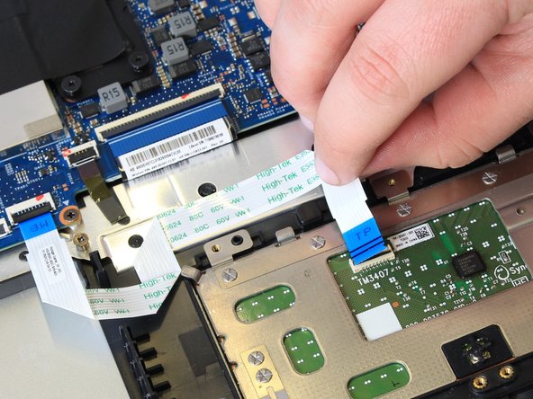

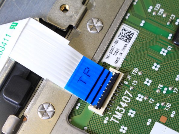

  6. HP Envy x360 15m-cn0012dx TrackPad Replacement: crwdns2935265:06crwdnd2935265:01crwdnd2935265:03crwdne2935265:0 HP Envy x360 15m-cn0012dx TrackPad Replacement: crwdns2935265:06crwdnd2935265:02crwdnd2935265:03crwdne2935265:0 HP Envy x360 15m-cn0012dx TrackPad Replacement: crwdns2935265:06crwdnd2935265:03crwdnd2935265:03crwdne2935265:0
    • Use the iFixit opening tool, lift up the black lock tab of the ZIF connector.
    • Pull out the ribbon cable from the trackpad connector.
  7. HP Envy x360 15m-cn0012dx TrackPad Replacement: crwdns2935265:07crwdnd2935265:01crwdnd2935265:02crwdne2935265:0 HP Envy x360 15m-cn0012dx TrackPad Replacement: crwdns2935265:07crwdnd2935265:02crwdnd2935265:02crwdne2935265:0
