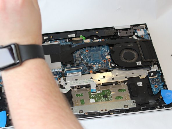

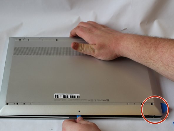

    • Pry open the back cover using the iFixit Opening Tool.
    • While using the tool, place a pick at each corner of the computer (be careful and do it slowly).
    • Once all the corners are slightly lifted, carefully pop off the back cover.
  4. HP Envy x360 15m-cn0012dx Hard Drive Replacement: crwdns2935265:04crwdnd2935265:01crwdnd2935265:02crwdne2935265:0 HP Envy x360 15m-cn0012dx Hard Drive Replacement: crwdns2935265:04crwdnd2935265:02crwdnd2935265:02crwdne2935265:0
    • Use the Phillips #0 screwdriver to remove one screw from the bottom left corner of the laptop.
    • Use the iFixit opening tool to lift the latch and detach the connector to the motherboard.
    • Remove the hard drive.
    • When replacing the hard drive, you will likely have to transfer the SATA cable and hardware from your old drive to the new one before reinstalling.
