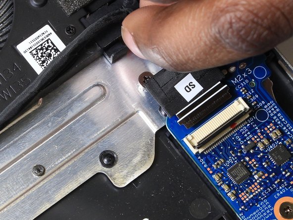

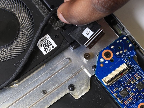

    • Use the iFixit opening tool to unlatch the ZIF connector with the cable labelled 'SD' from the daughterboard.
    • Slide out the interconnect ribbon cable.
  5. HP Envy x360 15m-cn0012dx Daughterboard Replacement: crwdns2935265:05crwdnd2935265:01crwdnd2935265:03crwdne2935265:0 HP Envy x360 15m-cn0012dx Daughterboard Replacement: crwdns2935265:05crwdnd2935265:02crwdnd2935265:03crwdne2935265:0 HP Envy x360 15m-cn0012dx Daughterboard Replacement: crwdns2935265:05crwdnd2935265:03crwdnd2935265:03crwdne2935265:0
    • Using a Phillips #0 screwdriver, remove the two 4mm screws on holding down the SD card daughterboard.
    • Remove the SD card daughterboard.
