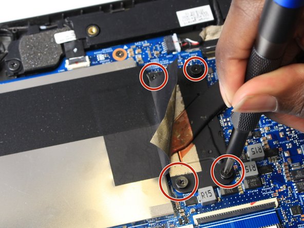

  5. HP Envy x360 15m-cn0012dx  Fan Replacement: crwdns2935265:05crwdnd2935265:01crwdnd2935265:02crwdne2935265:0 HP Envy x360 15m-cn0012dx  Fan Replacement: crwdns2935265:05crwdnd2935265:02crwdnd2935265:02crwdne2935265:0
    • Peel back the tape from the heatsink.
    • Use the Phillips #0 screwdriver to remove the four captive screws from the heatsink.
    • These screws will stay inside the heatsink while it is removed, simply loosen them until they disengage from the case and the heatsink becomes loose.
  6. HP Envy x360 15m-cn0012dx  Fan Replacement: crwdns2935265:06crwdnd2935265:01crwdnd2935265:02crwdne2935265:0 HP Envy x360 15m-cn0012dx  Fan Replacement: crwdns2935265:06crwdnd2935265:02crwdnd2935265:02crwdne2935265:0
    • Unlatch the black cable from the plastic guides on the fan.
    • Lift the fan from the laptop case.

You didn't show how to remove the Fan. You removed the Fan and Heat Sink. There's 4 more screws. Finish the job.
philw395 - crwdns2934203:0crwdne2934203:0
Uh, this video is not complete. You have to remove the four very tiny screws that hold the fan into the fan enclosure, replace the fan, and replace those four screws (very precise work to get those screws back in).
Also left out the reapplication of thermal grease between the heat sink and the processor.
