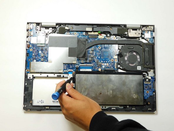

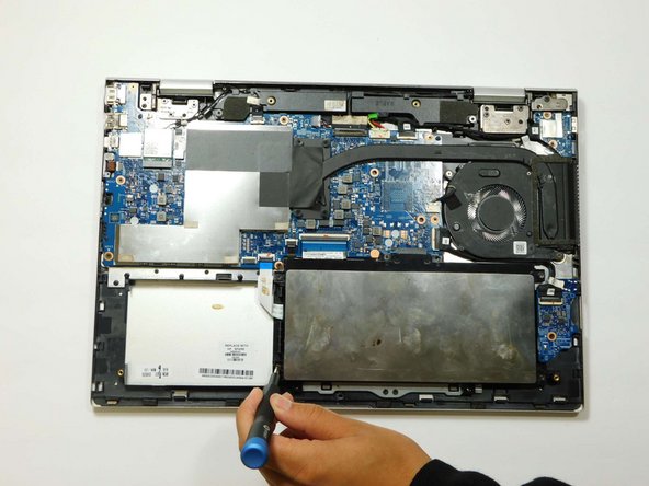

  4. HP Envy x360 15m-cn0011dx Battery Replacement, Battery: crwdns2935265:04crwdnd2935265:01crwdnd2935265:03crwdne2935265:0 HP Envy x360 15m-cn0011dx Battery Replacement, Battery: crwdns2935265:04crwdnd2935265:02crwdnd2935265:03crwdne2935265:0 HP Envy x360 15m-cn0011dx Battery Replacement, Battery: crwdns2935265:04crwdnd2935265:03crwdnd2935265:03crwdne2935265:0
    • Remove the six 3.3 mm screws from the battery pack using a Phillips #00 screwdriver.
  5. HP Envy x360 15m-cn0011dx Battery Replacement: crwdns2935265:05crwdnd2935265:01crwdnd2935265:01crwdne2935265:0
    • Lift the battery from the bottom of the laptop and and gently lift it up as you slowly unplug it from the connector on the top of the battery pack.
