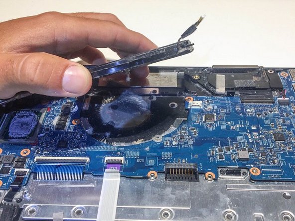

  3. HP Envy x360 15m-bq121dx Cooling Fan Replacement: crwdns2935265:03crwdnd2935265:01crwdnd2935265:01crwdne2935265:0
    • Use the Philips #0 screwdriver to remove seven 2 mm screws from battery.
  4. HP Envy x360 15m-bq121dx Cooling Fan Replacement: crwdns2935265:04crwdnd2935265:01crwdnd2935265:01crwdne2935265:0
    • Lift and pull the front of the battery up and out away from the connector to remove.
  5. HP Envy x360 15m-bq121dx Cooling Fan Replacement: crwdns2935265:05crwdnd2935265:01crwdnd2935265:02crwdne2935265:0 HP Envy x360 15m-bq121dx Cooling Fan Replacement: crwdns2935265:05crwdnd2935265:02crwdnd2935265:02crwdne2935265:0
    • Using a Philips #0 screwdriver, remove the three 2 mm screws located around the cooling fan as shown in this picture.
    • The fan may have sharp edges so be careful upon removal.

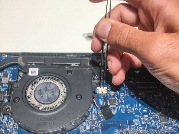

  6. HP Envy x360 15m-bq121dx Cooling Fan Replacement: crwdns2935265:06crwdnd2935265:01crwdnd2935265:02crwdne2935265:0 HP Envy x360 15m-bq121dx Cooling Fan Replacement: crwdns2935265:06crwdnd2935265:02crwdnd2935265:02crwdne2935265:0
    • Remove the connector clip with the tweezers.
