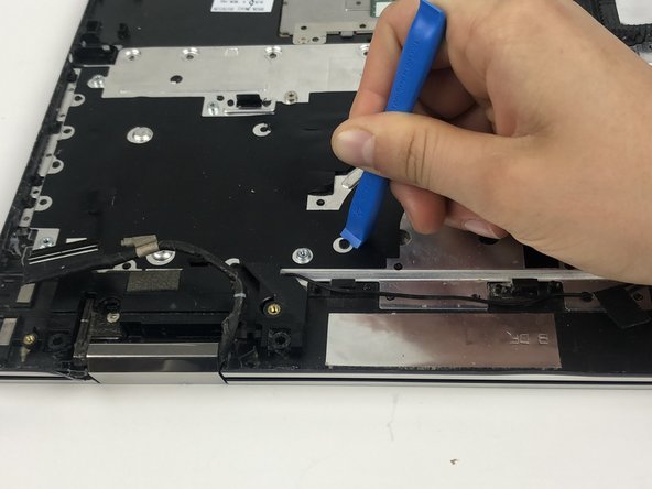

  14. HP Envy x360 15m-bq021dx Keyboard Replacement, Keyboard: crwdns2935265:014crwdnd2935265:01crwdnd2935265:03crwdne2935265:0 HP Envy x360 15m-bq021dx Keyboard Replacement, Keyboard: crwdns2935265:014crwdnd2935265:02crwdnd2935265:03crwdne2935265:0 HP Envy x360 15m-bq021dx Keyboard Replacement, Keyboard: crwdns2935265:014crwdnd2935265:03crwdnd2935265:03crwdne2935265:0

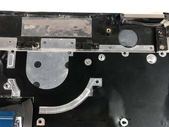

    • Use flat cutters or an iFixit Opening Tool to cut the excess plastic off the plastic pins holding the keyboard backing plate.
    • Make sure just to remove the excess plastic because to reinstall the backing plate the pins must be melted back around the backing plate.
    • When reassembling move back to the last step now (Step 21).

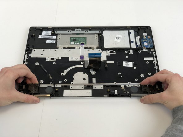

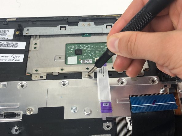

  15. HP Envy x360 15m-bq021dx Keyboard Replacement: crwdns2935265:015crwdnd2935265:01crwdnd2935265:03crwdne2935265:0 HP Envy x360 15m-bq021dx Keyboard Replacement: crwdns2935265:015crwdnd2935265:02crwdnd2935265:03crwdne2935265:0 HP Envy x360 15m-bq021dx Keyboard Replacement: crwdns2935265:015crwdnd2935265:03crwdnd2935265:03crwdne2935265:0

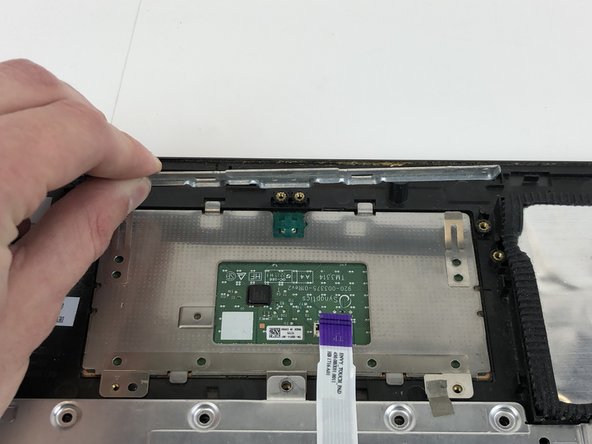

    • Remove the two M2.0x3.2 screws using a Phillips #0 screwdriver holding the bracket.
    • Lift the upper bracket off.
    • Remove the three M3.0x3.2 screws using the Phillips #0 screwdriver securing the touchpad.

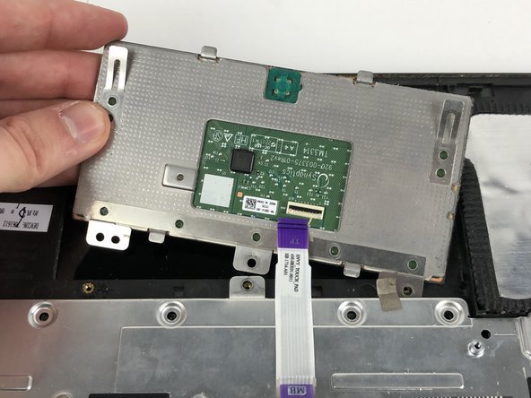

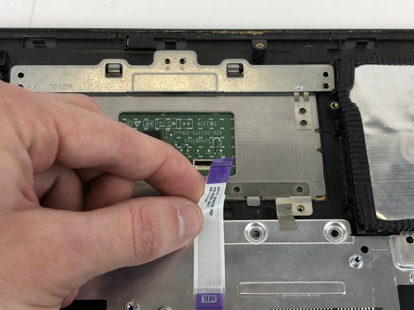

  16. HP Envy x360 15m-bq021dx Keyboard Replacement: crwdns2935265:016crwdnd2935265:01crwdnd2935265:03crwdne2935265:0 HP Envy x360 15m-bq021dx Keyboard Replacement: crwdns2935265:016crwdnd2935265:02crwdnd2935265:03crwdne2935265:0 HP Envy x360 15m-bq021dx Keyboard Replacement: crwdns2935265:016crwdnd2935265:03crwdnd2935265:03crwdne2935265:0
    • Use an iFixit opening tool to lift the locking flap and pull the ribbon cable out.
    • Lift the touch pad out of the frame.
    • When reassembling use tweezers to hold and insert the ribbon cable. Also, the middle flange of the touchpad goes above the flange on the plate.

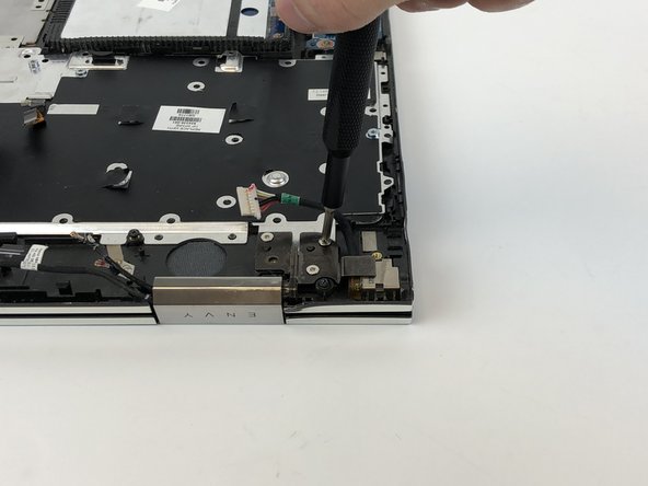

    • Using a Phillips #0 screwdriver, remove the three screws on both hinges.
    • Pry the hinges back so they are not blocking the keyboard backing plate.
    • If the case comes off the hinges slide the case back to the hinges and push the case in place.

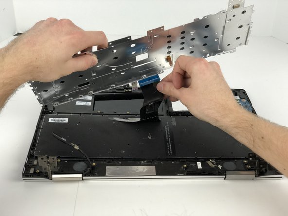

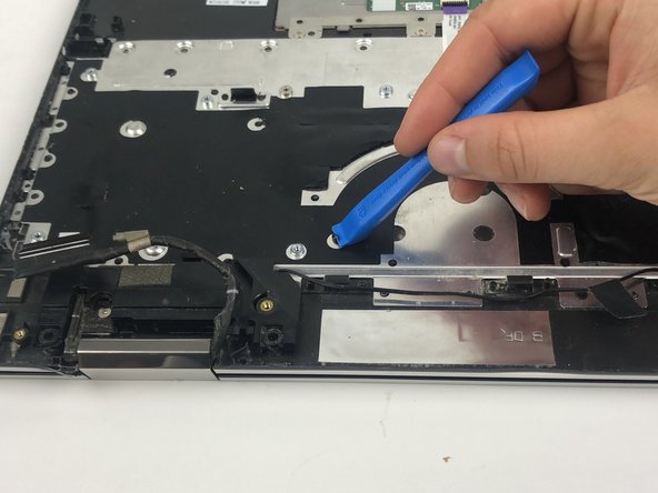

    • Pull the keyboard backing plate off of the laptop but be aware that it is connected to a ribbon cable still.
    • It might take some force to pry the plate from the pins.
    • Pull the keyboard ribbon cable off the backing plate and through it.
    • When reassembling, make sure the side with the black markings is facing up.
  19. HP Envy x360 15m-bq021dx Keyboard Replacement: crwdns2935265:019crwdnd2935265:01crwdnd2935265:02crwdne2935265:0 HP Envy x360 15m-bq021dx Keyboard Replacement: crwdns2935265:019crwdnd2935265:02crwdnd2935265:02crwdne2935265:0

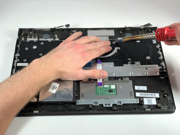

    • To reassemble follow the previous steps in reverse until reaching step 15.
    • Instead of completing step 15 complete the following step.
    • Using a soldering iron and melt the plastic pins so the plastic holds the backing plate down.
    • Make sure the plate is pressed down firmly as the pins are melted so that the plate is held tightly by the pins.
