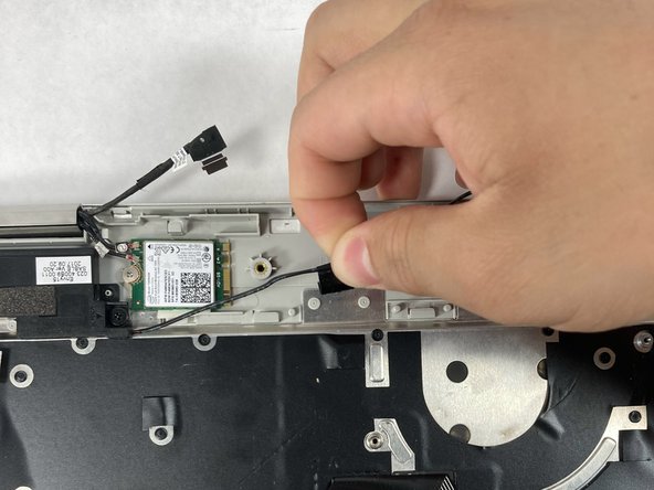

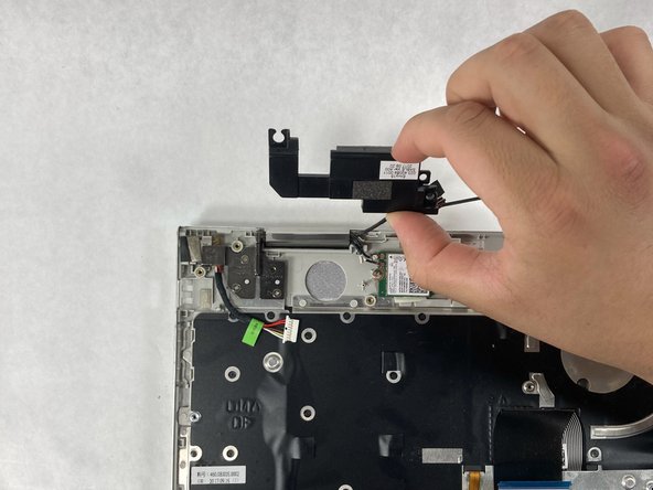

  20. HP Envy x360 15m-bp112dx Screen Assembly Replacement, Speakers: crwdns2935265:020crwdnd2935265:01crwdnd2935265:03crwdne2935265:0 HP Envy x360 15m-bp112dx Screen Assembly Replacement, Speakers: crwdns2935265:020crwdnd2935265:02crwdnd2935265:03crwdne2935265:0 HP Envy x360 15m-bp112dx Screen Assembly Replacement, Speakers: crwdns2935265:020crwdnd2935265:03crwdnd2935265:03crwdne2935265:0
    • The removal of the right speaker is located in the motherboard guide during steps 1-4.
    • Remove the two 1.5 mm Phillips screws.
    • Carefully peel the tape back.
    • Pull the left speaker cord around the plastic clips.
  21. HP Envy x360 15m-bp112dx Screen Assembly Replacement: crwdns2935265:021crwdnd2935265:01crwdnd2935265:02crwdne2935265:0 HP Envy x360 15m-bp112dx Screen Assembly Replacement: crwdns2935265:021crwdnd2935265:02crwdnd2935265:02crwdne2935265:0
    • Carefully remove the left speaker by pulling up vertically.

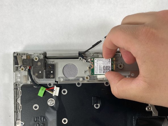

  22. HP Envy x360 15m-bp112dx Screen Assembly Replacement, Screen Assembly: crwdns2935265:022crwdnd2935265:01crwdnd2935265:02crwdne2935265:0 HP Envy x360 15m-bp112dx Screen Assembly Replacement, Screen Assembly: crwdns2935265:022crwdnd2935265:02crwdnd2935265:02crwdne2935265:0
    • Remove the four 5 mm Phillips screws.
    • Remove the one 5 mm Phillips screw.
    • Carefully remove the Wi-Fi card, lifting upwards.

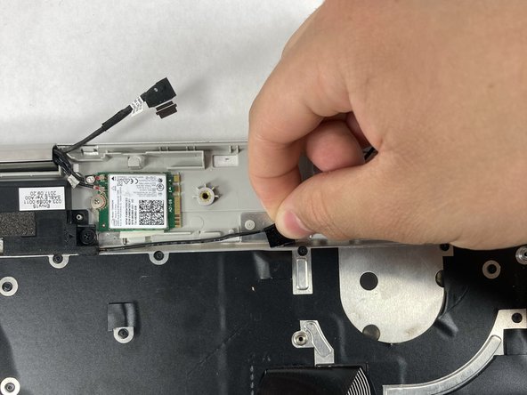

  23. HP Envy x360 15m-bp112dx Screen Assembly Replacement: crwdns2935265:023crwdnd2935265:01crwdnd2935265:03crwdne2935265:0 HP Envy x360 15m-bp112dx Screen Assembly Replacement: crwdns2935265:023crwdnd2935265:02crwdnd2935265:03crwdne2935265:0 HP Envy x360 15m-bp112dx Screen Assembly Replacement: crwdns2935265:023crwdnd2935265:03crwdnd2935265:03crwdne2935265:0
    • Disconnect the wires from the Wi-Fi card by using an opening tool and pulling the wires upwards.
