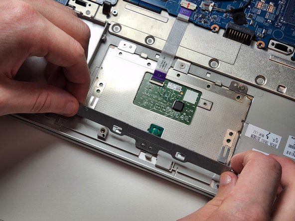

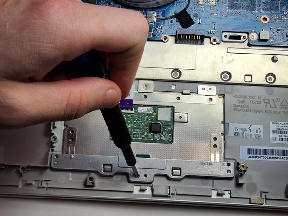

  5. HP Envy x360 15m-bp111dx Touchpad Replacement, Touchpad: crwdns2935265:05crwdnd2935265:01crwdnd2935265:03crwdne2935265:0 HP Envy x360 15m-bp111dx Touchpad Replacement, Touchpad: crwdns2935265:05crwdnd2935265:02crwdnd2935265:03crwdne2935265:0 HP Envy x360 15m-bp111dx Touchpad Replacement, Touchpad: crwdns2935265:05crwdnd2935265:03crwdnd2935265:03crwdne2935265:0
    • Use a Phillips screwdriver to remove the four 3.5 mm screws securing the bar on the touchpad.
    • Remove the bar from the touchpad.

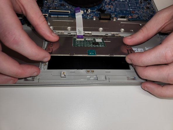

  6. HP Envy x360 15m-bp111dx Touchpad Replacement: crwdns2935265:06crwdnd2935265:01crwdnd2935265:02crwdne2935265:0 HP Envy x360 15m-bp111dx Touchpad Replacement: crwdns2935265:06crwdnd2935265:02crwdnd2935265:02crwdne2935265:0
    • Use a Phillips screwdriver to remove the three 2 mm screws securing the touchpad.

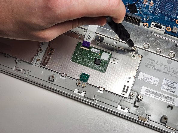

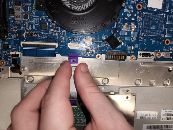

  7. HP Envy x360 15m-bp111dx Touchpad Replacement: crwdns2935265:07crwdnd2935265:01crwdnd2935265:03crwdne2935265:0 HP Envy x360 15m-bp111dx Touchpad Replacement: crwdns2935265:07crwdnd2935265:02crwdnd2935265:03crwdne2935265:0 HP Envy x360 15m-bp111dx Touchpad Replacement: crwdns2935265:07crwdnd2935265:03crwdnd2935265:03crwdne2935265:0
    • Flip the lock open on the ZIF connector using the opening tool to detach the ribbon from the motherboard.
    • Gently remove the touchpad from the motherboard.
  8. HP Envy x360 15m-bp111dx Touchpad Replacement: crwdns2935265:08crwdnd2935265:01crwdnd2935265:01crwdne2935265:0
    • The touchpad is now removed.
