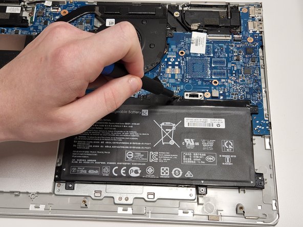

  3. HP Envy x360 15m-bp111dx Hard Drive Replacement, Battery: crwdns2935265:03crwdnd2935265:01crwdnd2935265:02crwdne2935265:0 HP Envy x360 15m-bp111dx Hard Drive Replacement, Battery: crwdns2935265:03crwdnd2935265:02crwdnd2935265:02crwdne2935265:0
    • Use a Phillips screwdriver to remove the seven 4 mm screws securing the battery.
  4. HP Envy x360 15m-bp111dx Hard Drive Replacement: crwdns2935265:04crwdnd2935265:01crwdnd2935265:03crwdne2935265:0 HP Envy x360 15m-bp111dx Hard Drive Replacement: crwdns2935265:04crwdnd2935265:02crwdnd2935265:03crwdne2935265:0 HP Envy x360 15m-bp111dx Hard Drive Replacement: crwdns2935265:04crwdnd2935265:03crwdnd2935265:03crwdne2935265:0
    • Carefully lift the battery, and pull it towards you to remove it.

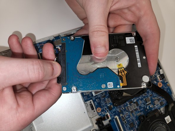

  5. HP Envy x360 15m-bp111dx Hard Drive Replacement, Hard Drive: crwdns2935265:05crwdnd2935265:01crwdnd2935265:01crwdne2935265:0
    • The hard drive bay is located in the lower left corner of the computer.
    • The hard drive will be covered by a black rubber sheath which can be removed by simply pulling it off of the hard drive (not pictured).

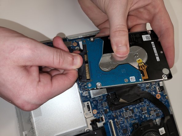

  6. HP Envy x360 15m-bp111dx Hard Drive Replacement: crwdns2935265:06crwdnd2935265:01crwdnd2935265:03crwdne2935265:0 HP Envy x360 15m-bp111dx Hard Drive Replacement: crwdns2935265:06crwdnd2935265:02crwdnd2935265:03crwdne2935265:0 HP Envy x360 15m-bp111dx Hard Drive Replacement: crwdns2935265:06crwdnd2935265:03crwdnd2935265:03crwdne2935265:0
    • Pull the rubber casing away from the drive (not pictured here) and gently lift the hard drive out of the computer.
    • Unplug the drive from power by grabbing the SATA / power cable on the plastic edge and pulling it away from the drive.
    • Do not disconnect the ribbon cable from the motherboard.
  7. HP Envy x360 15m-bp111dx Hard Drive Replacement: crwdns2935265:07crwdnd2935265:01crwdnd2935265:01crwdne2935265:0
    • The hard drive is now removed and can be replaced.
