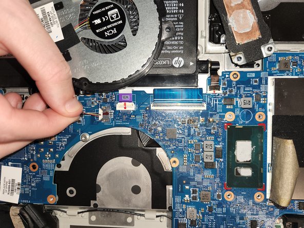

    • Loosen the screws on the heatsink using the Phillips screwdriver.
    • Do not force the screws to come out of the heatsink; they are meant to stay in place.
  5. HP Envy x360 15m-bp111dx Cooling Fan Replacement: crwdns2935265:05crwdnd2935265:01crwdnd2935265:01crwdne2935265:0
    • Remove the tape from the heat sink by pulling upwards.
  6. HP Envy x360 15m-bp111dx Cooling Fan Replacement: crwdns2935265:06crwdnd2935265:01crwdnd2935265:02crwdne2935265:0 HP Envy x360 15m-bp111dx Cooling Fan Replacement: crwdns2935265:06crwdnd2935265:02crwdnd2935265:02crwdne2935265:0
    Halberd Spudger
    $2.99
    • Using the halberd spudger, remove the sliding connector directly beside the fan.
  7. HP Envy x360 15m-bp111dx Cooling Fan Replacement: crwdns2935265:07crwdnd2935265:01crwdnd2935265:03crwdne2935265:0 HP Envy x360 15m-bp111dx Cooling Fan Replacement: crwdns2935265:07crwdnd2935265:02crwdnd2935265:03crwdne2935265:0 HP Envy x360 15m-bp111dx Cooling Fan Replacement: crwdns2935265:07crwdnd2935265:03crwdnd2935265:03crwdne2935265:0
    • Lift the fan assembly from the computer to remove it.
