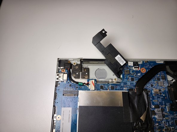

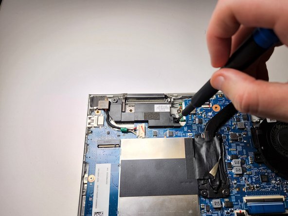

    • Use a Phillips #0 screwdriver to remove the two M2x3.1 screws that secure the speaker in place.
    • Lift and move the speaker to the side.
    • Do not pull too hard on the speaker. It is connected by thin wires that run under the motherboard.

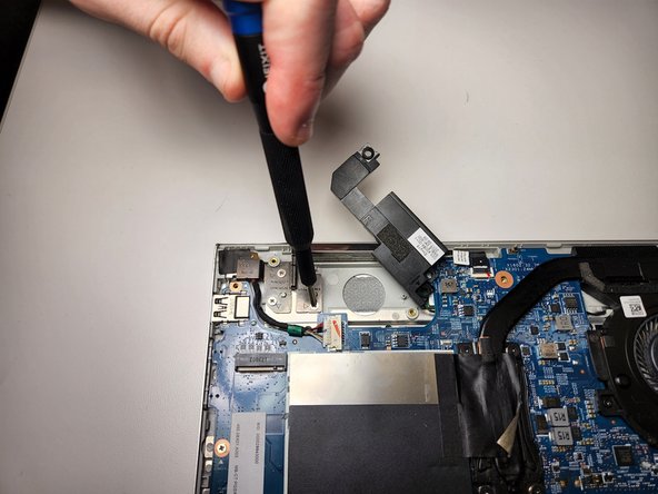

  4. HP Envy x360 15m-bp111dx Charging Port Replacement: crwdns2935265:04crwdnd2935265:01crwdnd2935265:02crwdne2935265:0 HP Envy x360 15m-bp111dx Charging Port Replacement: crwdns2935265:04crwdnd2935265:02crwdnd2935265:02crwdne2935265:0
    • Use a Phillips #0 screwdriver to remove remove three M2.5x4 screws that secure the hinge.
