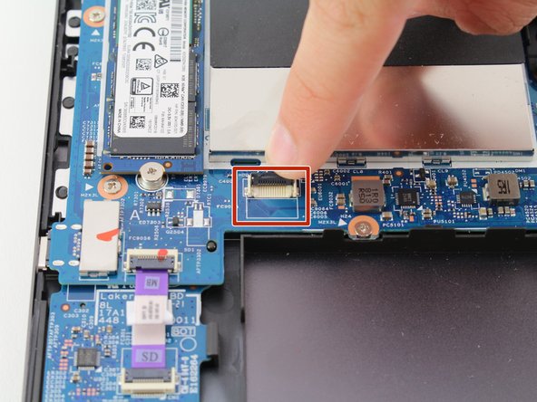

  5. HP Envy x360 15-bp143cl Hard Drive Replacement: crwdns2935265:05crwdnd2935265:01crwdnd2935265:02crwdne2935265:0 HP Envy x360 15-bp143cl Hard Drive Replacement: crwdns2935265:05crwdnd2935265:02crwdnd2935265:02crwdne2935265:0
    • Lift the black tab securing the hard drive connecting cable to the laptop to remove the cable.
  6. HP Envy x360 15-bp143cl Hard Drive Replacement: crwdns2935265:06crwdnd2935265:01crwdnd2935265:01crwdne2935265:0
    • Lift the hard drive from its slot.
    • If the hard drive is attached using adhesive, use an opening tool to pry it from the laptop.
