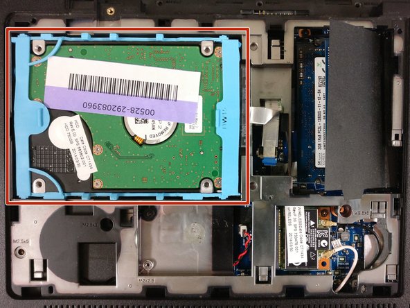

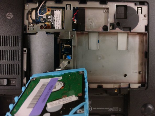

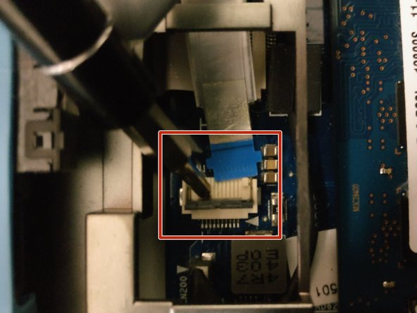

  4. HP Envy m6-n010dx Speaker Replacement: crwdns2935265:04crwdnd2935265:01crwdnd2935265:03crwdne2935265:0 HP Envy m6-n010dx Speaker Replacement: crwdns2935265:04crwdnd2935265:02crwdnd2935265:03crwdne2935265:0 HP Envy m6-n010dx Speaker Replacement: crwdns2935265:04crwdnd2935265:03crwdnd2935265:03crwdne2935265:0
    • The hard drive is connected to the motherboard via this blue-tabbed cable, highlighted in red.
    • Gently pry off the cover to release the cable.
    • Slowly lift the hard drive out and away from the device.

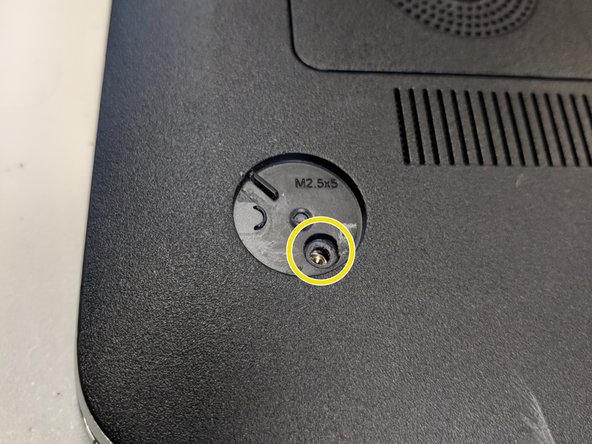

  5. HP Envy m6-n010dx Speaker Replacement, Speaker: crwdns2935265:05crwdnd2935265:01crwdnd2935265:03crwdne2935265:0 HP Envy m6-n010dx Speaker Replacement, Speaker: crwdns2935265:05crwdnd2935265:02crwdnd2935265:03crwdne2935265:0 HP Envy m6-n010dx Speaker Replacement, Speaker: crwdns2935265:05crwdnd2935265:03crwdnd2935265:03crwdne2935265:0
    • Remove the marked screws.
    • Pry off the lower two grip pads.
    • You may need to use more force than feels necessary.
    • Remove the two additional screws underneath the lower grip pads.
    • Remove the large back panel to reveal the inner workings.
    • The back panel might be difficult to remove. Use a flat object to help pry it off, and don't be afraid to use force.

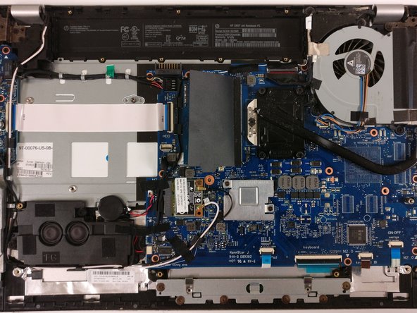

  6. HP Envy m6-n010dx Speaker Replacement: crwdns2935265:06crwdnd2935265:01crwdnd2935265:03crwdne2935265:0 HP Envy m6-n010dx Speaker Replacement: crwdns2935265:06crwdnd2935265:02crwdnd2935265:03crwdne2935265:0 HP Envy m6-n010dx Speaker Replacement: crwdns2935265:06crwdnd2935265:03crwdnd2935265:03crwdne2935265:0
    • Locate the speaker.
    • Locate the tape on the speaker.
    • Peel back the tape, disconnecting it from the speaker.
    • When reassembling the speaker, make sure to use new electrical tape so it will stick.

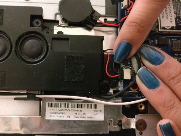

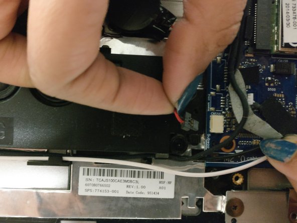

  7. HP Envy m6-n010dx Speaker Replacement: crwdns2935265:07crwdnd2935265:01crwdnd2935265:03crwdne2935265:0 HP Envy m6-n010dx Speaker Replacement: crwdns2935265:07crwdnd2935265:02crwdnd2935265:03crwdne2935265:0 HP Envy m6-n010dx Speaker Replacement: crwdns2935265:07crwdnd2935265:03crwdnd2935265:03crwdne2935265:0
    • Locate the connecting wire attached to the speaker.
    • Disconnect the wire.
