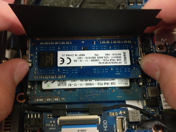

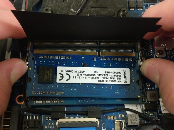

  5. HP Envy m6-n010dx RAM Replacement, RAM: crwdns2935265:05crwdnd2935265:01crwdnd2935265:03crwdne2935265:0 HP Envy m6-n010dx RAM Replacement, RAM: crwdns2935265:05crwdnd2935265:02crwdnd2935265:03crwdne2935265:0 HP Envy m6-n010dx RAM Replacement, RAM: crwdns2935265:05crwdnd2935265:03crwdnd2935265:03crwdne2935265:0
    • Remove the highlighted screws
    • Pry off the lower two grip pads
    • You may need to use more force than feels necessary
    • Remove the two additional screws underneath the lower grip pads
    • Remove the large back panel to reveal the inner workings
    • The back panel might be difficult to remove. Use a flat object to help pry it off, and don't be afraid to use force.
  6. HP Envy m6-n010dx RAM Replacement: crwdns2935265:06crwdnd2935265:01crwdnd2935265:03crwdne2935265:0 HP Envy m6-n010dx RAM Replacement: crwdns2935265:06crwdnd2935265:02crwdnd2935265:03crwdne2935265:0 HP Envy m6-n010dx RAM Replacement: crwdns2935265:06crwdnd2935265:03crwdnd2935265:03crwdne2935265:0
    • Pull back the black rectangular cover to reveal the RAM
    • Unclip the metal restraints on the side to pop out the RAM
    • Repeat the previous step for the second RAM below
