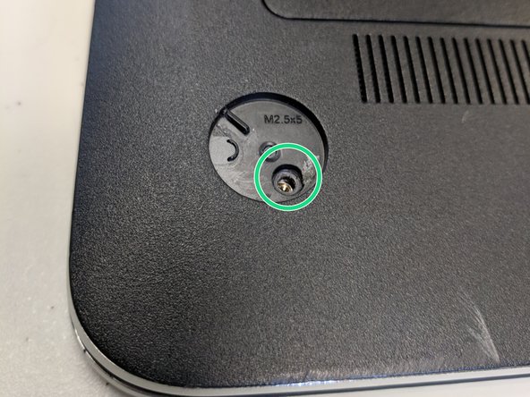

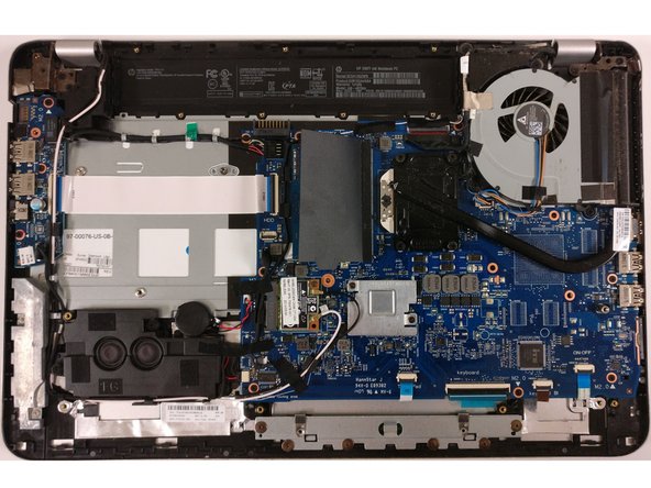

  5. HP Envy m6-n010dx Fan Replacement, Fan: crwdns2935265:05crwdnd2935265:01crwdnd2935265:03crwdne2935265:0 HP Envy m6-n010dx Fan Replacement, Fan: crwdns2935265:05crwdnd2935265:02crwdnd2935265:03crwdne2935265:0 HP Envy m6-n010dx Fan Replacement, Fan: crwdns2935265:05crwdnd2935265:03crwdnd2935265:03crwdne2935265:0
    • Remove the screws highlighted in red
    • Pry off with prying tool the lower two grip pads highlighted in orange
    • You may need to use more force than feels necessary
    • Remove the two additional screws underneath the lower grip pads
    • Remove the large back panel to reveal the inner workings
    • The back panel might be difficult to remove. Use a flat object to help pry it off, and don't be afraid to use force.

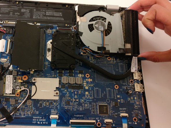

  6. HP Envy m6-n010dx Fan Replacement: crwdns2935265:06crwdnd2935265:01crwdnd2935265:03crwdne2935265:0 HP Envy m6-n010dx Fan Replacement: crwdns2935265:06crwdnd2935265:02crwdnd2935265:03crwdne2935265:0 HP Envy m6-n010dx Fan Replacement: crwdns2935265:06crwdnd2935265:03crwdnd2935265:03crwdne2935265:0
    • Locate fan
    • Gently remove tape that hold the heatsink and fan together
    • When reassembling , make sure to use new electrical tape so it will stick.
  7. HP Envy m6-n010dx Fan Replacement: crwdns2935265:07crwdnd2935265:01crwdnd2935265:03crwdne2935265:0 HP Envy m6-n010dx Fan Replacement: crwdns2935265:07crwdnd2935265:02crwdnd2935265:03crwdne2935265:0 HP Envy m6-n010dx Fan Replacement: crwdns2935265:07crwdnd2935265:03crwdnd2935265:03crwdne2935265:0
    • Loosen the four screws on the heat sink indicated in picture
    • Remove the heatsink
  8. HP Envy m6-n010dx Fan Replacement: crwdns2935265:08crwdnd2935265:01crwdnd2935265:02crwdne2935265:0 HP Envy m6-n010dx Fan Replacement: crwdns2935265:08crwdnd2935265:02crwdnd2935265:02crwdne2935265:0

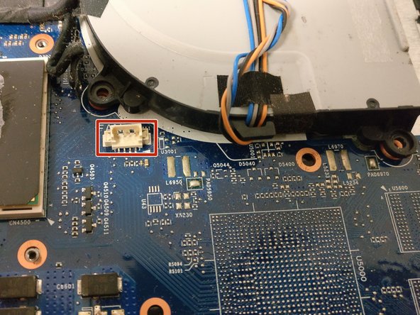

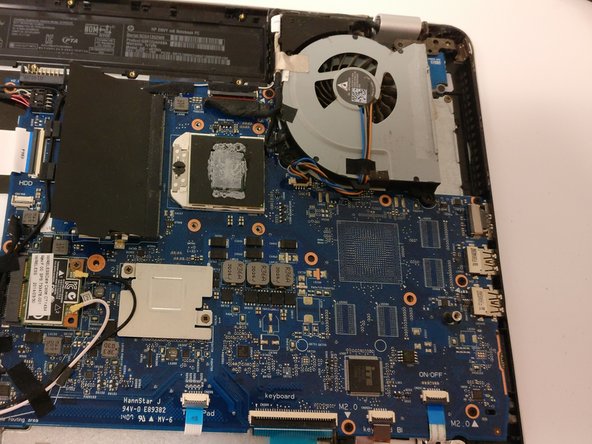

    • Gently disconnect the wire connecting the fan to the motherboard
  9. HP Envy m6-n010dx Fan Replacement: crwdns2935265:09crwdnd2935265:01crwdnd2935265:03crwdne2935265:0 HP Envy m6-n010dx Fan Replacement: crwdns2935265:09crwdnd2935265:02crwdnd2935265:03crwdne2935265:0 HP Envy m6-n010dx Fan Replacement: crwdns2935265:09crwdnd2935265:03crwdnd2935265:03crwdne2935265:0
    • Remove screws indicated in photo.
    • Remove fan
