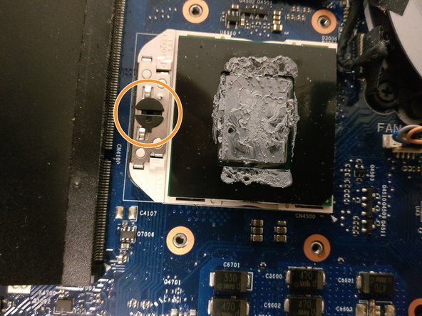

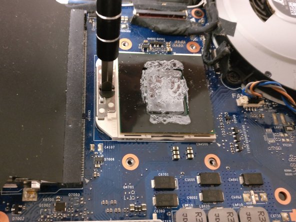

    • Find the uncovered CPU highlighted in red.
    • Turn the fastener, highlighted in orange, 180 degrees counterclockwise using a flat headed screwdriver to loosen the CPU.

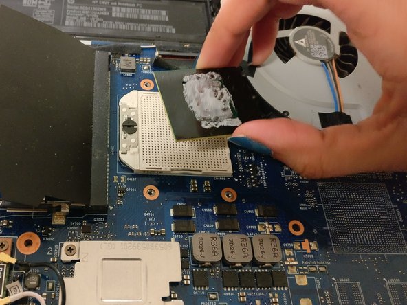

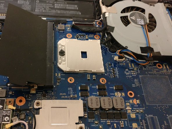

    • Gently lift up and remove the CPU
    • Only lift the CPU by the sides, making sure not to touch the bottom, otherwise you may damage your CPU.
    • Don't forget to apply a few drops of thermal paste when putting in a new CPU.
To reassemble your device, follow these instructions in reverse order. Be sure to apply new thermal paste if you are using a new CPU.
