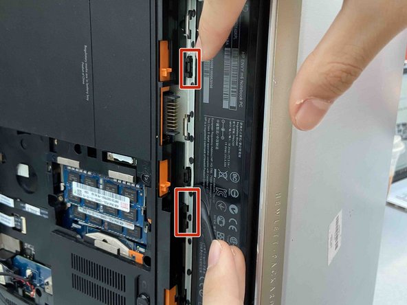

    • Pull the slide release tab to the left to free the battery.
    • Once the slide release is all the way over, a red icon should be visible.
    • As you pull the tab, the bottom edge of the battery should start to come up.
  3. HP Envy m6-1225dx TouchPad Buttons Replacement: crwdns2935265:03crwdnd2935265:01crwdnd2935265:01crwdne2935265:0
    • Remove the battery

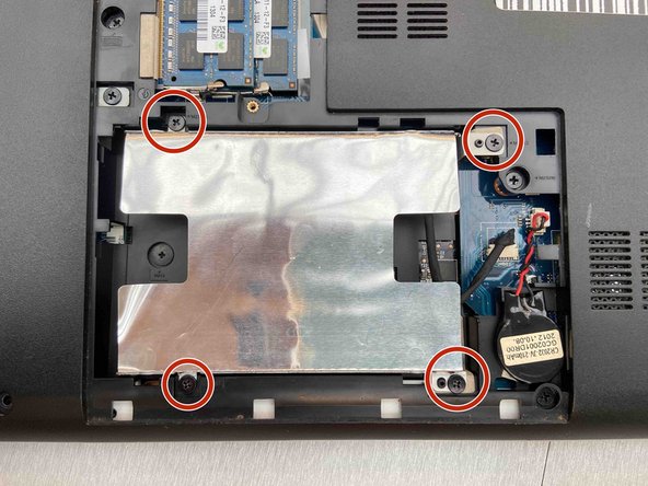

  9. HP Envy m6-1225dx TouchPad Buttons Replacement, TouchPad Buttons: crwdns2935265:09crwdnd2935265:01crwdnd2935265:02crwdne2935265:0 HP Envy m6-1225dx TouchPad Buttons Replacement, TouchPad Buttons: crwdns2935265:09crwdnd2935265:02crwdnd2935265:02crwdne2935265:0
    • Remove the 4 screws from the hard drive bracket with a Phillips #1 screwdriver.
  10. HP Envy m6-1225dx TouchPad Buttons Replacement: crwdns2935265:010crwdnd2935265:01crwdnd2935265:01crwdne2935265:0
    • Disconnect the cable from the side of the hard drive and move it to the side
    • Remove the hard drive from the laptop.
    • Our laptop did not have a hard drive when we disassembled it.

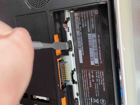

  12. HP Envy m6-1225dx TouchPad Buttons Replacement: crwdns2935265:012crwdnd2935265:01crwdnd2935265:03crwdne2935265:0 HP Envy m6-1225dx TouchPad Buttons Replacement: crwdns2935265:012crwdnd2935265:02crwdnd2935265:03crwdne2935265:0 HP Envy m6-1225dx TouchPad Buttons Replacement: crwdns2935265:012crwdnd2935265:03crwdnd2935265:03crwdne2935265:0
    • Move the laptop onto its left side with it open.
    • Turn the laptop and look into the empty battery slot for two release holes.
    • Insert a metal spudger into the release holes and apply pressure to the back of the keyboard till it comes loose of the laptop.

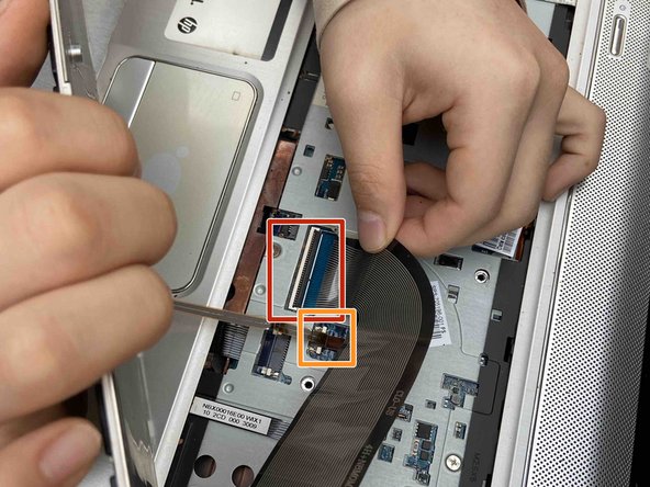

  13. HP Envy m6-1225dx TouchPad Buttons Replacement: crwdns2935265:013crwdnd2935265:01crwdnd2935265:02crwdne2935265:0 HP Envy m6-1225dx TouchPad Buttons Replacement: crwdns2935265:013crwdnd2935265:02crwdnd2935265:02crwdne2935265:0
    • Gently lift the keyboard away from the laptop.
    • Remove the cable connection from the base of the laptop.
    • Remove the keyboard backlight cable.
    • The keyboard backlight cable is only present on select models.

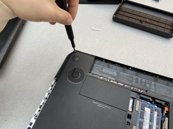

  14. HP Envy m6-1225dx TouchPad Buttons Replacement: crwdns2935265:014crwdnd2935265:01crwdnd2935265:02crwdne2935265:0 HP Envy m6-1225dx TouchPad Buttons Replacement: crwdns2935265:014crwdnd2935265:02crwdnd2935265:02crwdne2935265:0

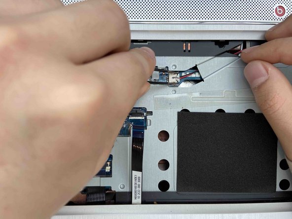

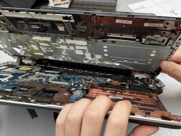

    • Remove the 13 screws on the bottom of the laptop using a Phillips #1 screwdriver.
  15. HP Envy m6-1225dx TouchPad Buttons Replacement: crwdns2935265:015crwdnd2935265:01crwdnd2935265:03crwdne2935265:0 HP Envy m6-1225dx TouchPad Buttons Replacement: crwdns2935265:015crwdnd2935265:02crwdnd2935265:03crwdne2935265:0 HP Envy m6-1225dx TouchPad Buttons Replacement: crwdns2935265:015crwdnd2935265:03crwdnd2935265:03crwdne2935265:0
    • Disconnect the power button board cable using a pair of tweezers.
    • Disconnect the touchpad button board cable using tweezers.
    • Disconnect the fingerprint reader board cable using tweezers.
    • Disconnect the right speaker cable using tweezers.
    • Remove the 4 screws using a Phillips #1 screwdriver.
    • Apply force to the base of the cover to pop if off from the laptop base.
    • Be sure the cable for the right speaker doesn't get caught on the cover as it is removed or the speaker could be damaged.

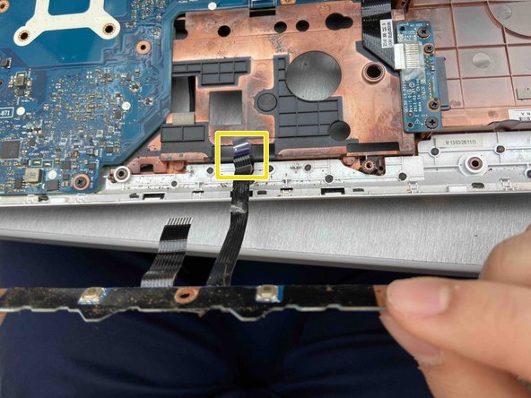

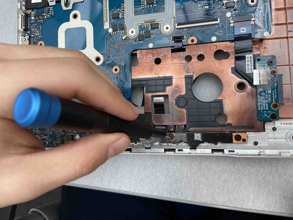

  16. HP Envy m6-1225dx TouchPad Buttons Replacement: crwdns2935265:016crwdnd2935265:01crwdnd2935265:03crwdne2935265:0 HP Envy m6-1225dx TouchPad Buttons Replacement: crwdns2935265:016crwdnd2935265:02crwdnd2935265:03crwdne2935265:0 HP Envy m6-1225dx TouchPad Buttons Replacement: crwdns2935265:016crwdnd2935265:03crwdnd2935265:03crwdne2935265:0
    • Turn the top cover with the touchpad area facing you.
    • Remove the one screw holding the touchpad buttons down with a Phillips #1 screwdriver.
    • Disconnect the cable holding the touchpad buttons to the top cover
