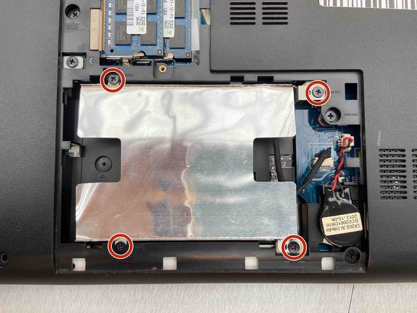

    • Remove the four Phillips #1 screws from the hard drive bracket.
  10. HP Envy m6-1225dx Speakers Replacement: crwdns2935265:010crwdnd2935265:01crwdnd2935265:01crwdne2935265:0
    • Disconnect the cable from the side of the hard drive and move to the side.
    • Remove the hard drive.
    • Our laptop did not have a hard drive when we disassembled it

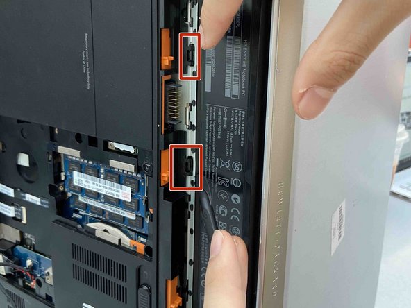

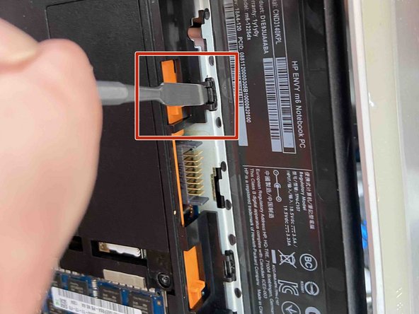

    • Make the device stand onto its left side with the device open.
    • Turn the laptop and look into the empty battery slot for two release holes.
    • Insert a metal spudger into the release holes and apply pressure to the back of the keyboard until it comes loose of the laptop.

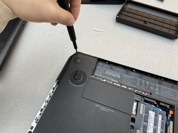

    • Remove the 13 screws on the bottom of the laptop that secure the top cover using a Phillips #1 screwdriver.

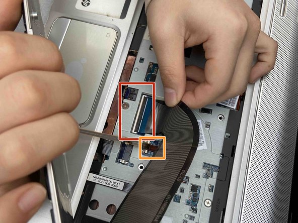

  15. HP Envy m6-1225dx Speakers Replacement: crwdns2935265:015crwdnd2935265:01crwdnd2935265:03crwdne2935265:0 HP Envy m6-1225dx Speakers Replacement: crwdns2935265:015crwdnd2935265:02crwdnd2935265:03crwdne2935265:0 HP Envy m6-1225dx Speakers Replacement: crwdns2935265:015crwdnd2935265:03crwdnd2935265:03crwdne2935265:0
    • Disconnect Power button board cable using a pair tweezers.
    • Disconnect Touch Pad button board cable using a pair tweezers.
    • Disconnect Fingerprint reader board cable using a pair tweezers.
    • Disconnect Right speaker cable using a pair tweezers.
    • Remove the 4 screws using a Phillips #1 screwdriver.
    • Apply force to the base of the cover to pop if off from the laptop base.
    • Be sure the cable for the right speaker doesn't get caught on the cover as it is removed or the speaker could be damaged.

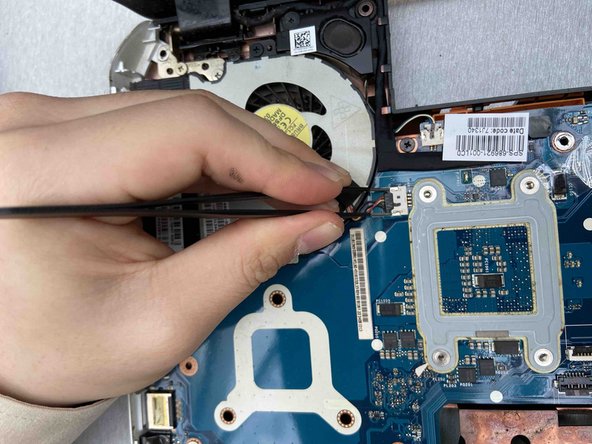

  16. HP Envy m6-1225dx Speakers Replacement: crwdns2935265:016crwdnd2935265:01crwdnd2935265:03crwdne2935265:0 HP Envy m6-1225dx Speakers Replacement: crwdns2935265:016crwdnd2935265:02crwdnd2935265:03crwdne2935265:0 HP Envy m6-1225dx Speakers Replacement: crwdns2935265:016crwdnd2935265:03crwdnd2935265:03crwdne2935265:0

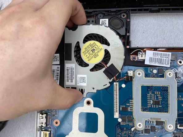

    • Remove the two screws holding the cooling fan down with a Phillips #1 screwdriver.
    • Disconnect the cooling fan cable using a pair tweezers.
    • Gently lift the cooling fan.

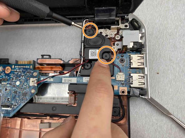

    • Remove the one screw on the left speaker with a Phillips #1 screwdriver.
    • Remove the two screws on the right speaker with a Phillips #1 screwdriver.
    • Lift the speakers straight out to remove them.
    • Be sure not the lose the 4 rubber bushings on the speakers as they are important to the speaker's performance.
