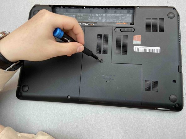

    • Remove the center screw using a Phillips #1 screwdriver.
  5. HP Envy m6-1225dx Optical Drive Replacement: crwdns2935265:05crwdnd2935265:01crwdnd2935265:02crwdne2935265:0 HP Envy m6-1225dx Optical Drive Replacement: crwdns2935265:05crwdnd2935265:02crwdnd2935265:02crwdne2935265:0
    • Move the battery slide release latch to the side while pulling the service cover forward.
    • Pull the service cover straight up and out to remove.

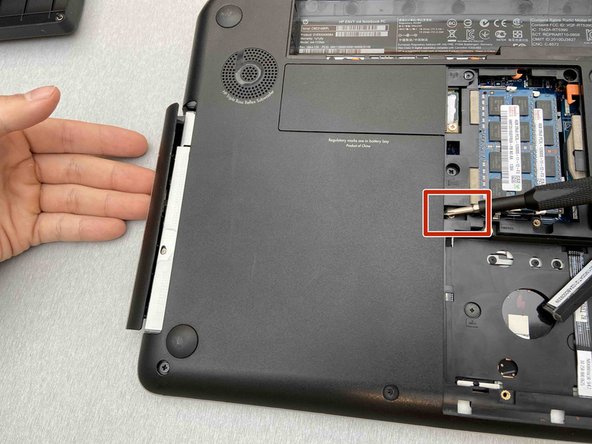

    • Use a Phillips #1 screwdriver to remove the single screw holding the optical drive
  7. HP Envy m6-1225dx Optical Drive Replacement: crwdns2935265:07crwdnd2935265:01crwdnd2935265:02crwdne2935265:0 HP Envy m6-1225dx Optical Drive Replacement: crwdns2935265:07crwdnd2935265:02crwdnd2935265:02crwdne2935265:0
    • Use a spudger to apply pressure to the tab, while simultaneously pulling out the optical drive.
    • While the images show the tab being pushed out with a screwdriver, we recommend using an ESD-safe instrument instead!
  8. HP Envy m6-1225dx Optical Drive Replacement: crwdns2935265:08crwdnd2935265:01crwdnd2935265:01crwdne2935265:0
    • Pull the optical drive out of the base of the laptop.
