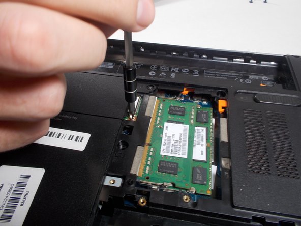

  4. HP Envy m6-1105dx WLAN Card Replacement: crwdns2935265:04crwdnd2935265:01crwdnd2935265:02crwdne2935265:0 HP Envy m6-1105dx WLAN Card Replacement: crwdns2935265:04crwdnd2935265:02crwdnd2935265:02crwdne2935265:0
    • Use a JIS #0 screwdriver to unscrew the small cover where the WLAN card is.
    • The screw does not come out all the way so unscrew it as far as you can then try to life the cover.

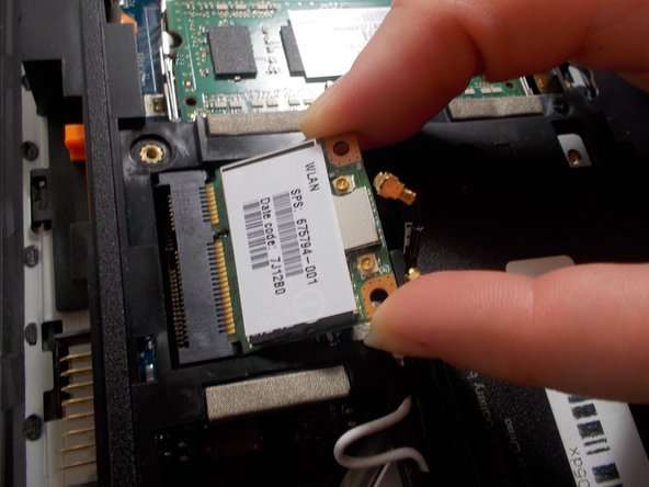

  5. HP Envy m6-1105dx WLAN Card Replacement: crwdns2935265:05crwdnd2935265:01crwdnd2935265:03crwdne2935265:0 HP Envy m6-1105dx WLAN Card Replacement: crwdns2935265:05crwdnd2935265:02crwdnd2935265:03crwdne2935265:0 HP Envy m6-1105dx WLAN Card Replacement: crwdns2935265:05crwdnd2935265:03crwdnd2935265:03crwdne2935265:0
    • Use a plastic opening tool to gently disconnect the WLAN antenna cables.
  6. HP Envy m6-1105dx WLAN Card Replacement: crwdns2935265:06crwdnd2935265:01crwdnd2935265:02crwdne2935265:0 HP Envy m6-1105dx WLAN Card Replacement: crwdns2935265:06crwdnd2935265:02crwdnd2935265:02crwdne2935265:0
    • Remove the two PM2.0×3.0 screws that secure the WLAN module to the base using the JIS #0 screwdriver.
    • Using two fingers, grab the sides of the WLAN card and slowly pull it out.
