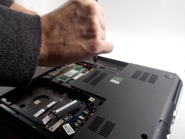

  3. HP Envy m6-1105dx Keyboard Replacement, Keyboard: crwdns2935265:03crwdnd2935265:01crwdnd2935265:01crwdne2935265:0
    • Release the screw in the center of the service cover.
    • Slide the battery release latch and pull cover towards you.
    • Lift cover off.
  4. HP Envy m6-1105dx Keyboard Replacement: crwdns2935265:04crwdnd2935265:01crwdnd2935265:03crwdne2935265:0 HP Envy m6-1105dx Keyboard Replacement: crwdns2935265:04crwdnd2935265:02crwdnd2935265:03crwdne2935265:0 HP Envy m6-1105dx Keyboard Replacement: crwdns2935265:04crwdnd2935265:03crwdnd2935265:03crwdne2935265:0

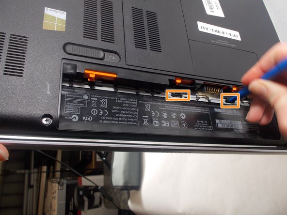

    • Remove the two JIS #0 screws that secure the keyboard to the computer.
    • Partially open the computer and rest it on its side.
    • Insert a plastic opening tool into the keyboard release holes on the inside of the battery area.
    • Press on the back of the keyboard until the keyboard disengages from the computer.

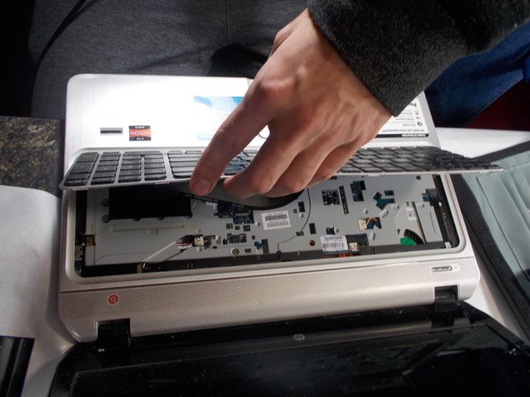

  5. HP Envy m6-1105dx Keyboard Replacement: crwdns2935265:05crwdnd2935265:01crwdnd2935265:02crwdne2935265:0 HP Envy m6-1105dx Keyboard Replacement: crwdns2935265:05crwdnd2935265:02crwdnd2935265:02crwdne2935265:0
    • Return the computer to its normal position, facing you and open.
    • Lift the rear edge of the keyboard.
    • Lift the keyboard towards the front of the computer, keeping it on an angle.
    • Lift the side of the keyboard until you can access the keyboard cable and the keyboard backlight cable.
  6. HP Envy m6-1105dx Keyboard Replacement: crwdns2935265:06crwdnd2935265:01crwdnd2935265:02crwdne2935265:0 HP Envy m6-1105dx Keyboard Replacement: crwdns2935265:06crwdnd2935265:02crwdnd2935265:02crwdne2935265:0
    • Release the keyboard connector cable (the wider of the two cables) by lifting the thin edge resting on top of the cable.
    • Disconnect the cable from the system board.
    • Disconnect the thinner backlight cable from the system board by pulling gently on the tab.
  7. HP Envy m6-1105dx Keyboard Replacement: crwdns2935265:07crwdnd2935265:01crwdnd2935265:01crwdne2935265:0
    • Remove the keyboard.

Unfortunately the instructions for the keyboard release inside the battery area don't really tell you which direction you should turn it. I'm afraid I'll break the plastic.
