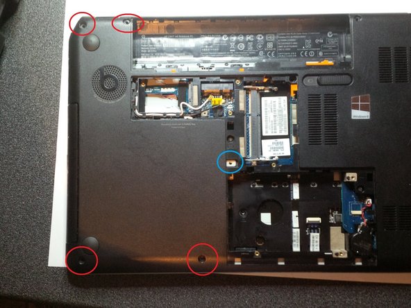

    5. HP Envy m6 1220sb Disassembly, removing the screws..: crwdns2935265:05crwdnd2935265:01crwdnd2935265:02crwdne2935265:0 HP Envy m6 1220sb Disassembly, removing the screws..: crwdns2935265:05crwdnd2935265:02crwdnd2935265:02crwdne2935265:0
      • now we will remove the screws of the case...
      • remove the screws in the red circles.
      • remove the screw in the blue circle , this is the screw from the dvd bay. You can remove this by using a metal spudger or a isesamo iopener.

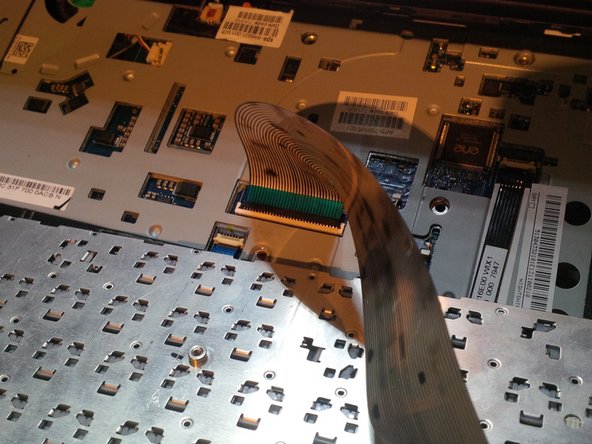

    8. HP Envy m6 1220sb Disassembly, Removing keyboard: crwdns2935265:08crwdnd2935265:01crwdnd2935265:02crwdne2935265:0 HP Envy m6 1220sb Disassembly, Removing keyboard: crwdns2935265:08crwdnd2935265:02crwdnd2935265:02crwdne2935265:0
      • turn the laptop arround so you can open the lid.
      • use a screwdriver or a spudger to push the little black "fingers" from the keyboard away from the case. If you do it right you'll hear clicks.
      • afterwards, lift the keyboard up and remove it from the mainboard connector. (lift up the little black lid (gently) en pull out the cable.)

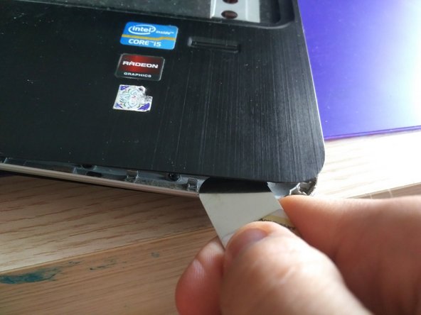

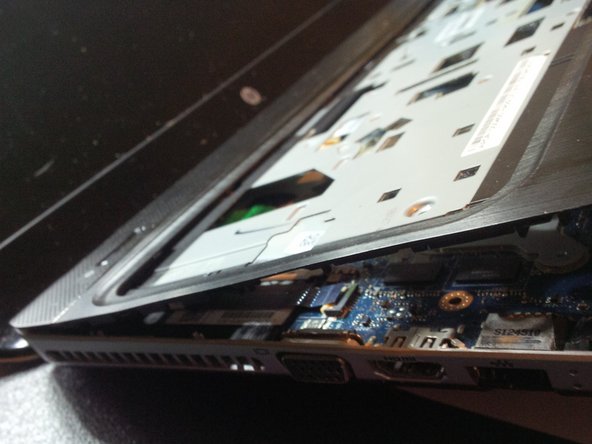

    10. HP Envy m6 1220sb Disassembly, opening the laptop: crwdns2935265:010crwdnd2935265:01crwdnd2935265:03crwdne2935265:0 HP Envy m6 1220sb Disassembly, opening the laptop: crwdns2935265:010crwdnd2935265:02crwdnd2935265:03crwdne2935265:0 HP Envy m6 1220sb Disassembly, opening the laptop: crwdns2935265:010crwdnd2935265:03crwdnd2935265:03crwdne2935265:0
      • use a isesamo opener or a spudger to open the case .
      • slide your tool against the case , you will hear clicks.
      • gently remove the upper plate. afterwards you will se the mainboard.

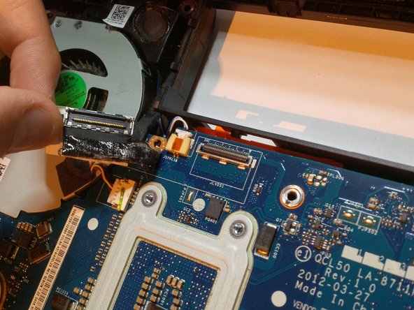

    11. HP Envy m6 1220sb Disassembly, mainboard/ screen connector: crwdns2935265:011crwdnd2935265:01crwdnd2935265:02crwdne2935265:0 HP Envy m6 1220sb Disassembly, mainboard/ screen connector: crwdns2935265:011crwdnd2935265:02crwdnd2935265:02crwdne2935265:0
      • remove the screen connector. be very very gently.. pull the black flap ( in the lime square ) towards you .
      • red circle : screw from mainboard.

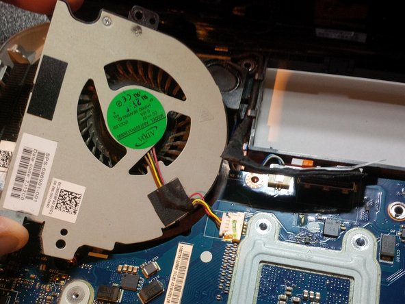

    13. HP Envy m6 1220sb Disassembly, removing the fan: crwdns2935265:013crwdnd2935265:01crwdnd2935265:02crwdne2935265:0 HP Envy m6 1220sb Disassembly, removing the fan: crwdns2935265:013crwdnd2935265:02crwdnd2935265:02crwdne2935265:0
      • remove the big screw you see in picture 1
      • we can remove the fan for taking out the mainboard or to clean the fan, or replace the fan.
