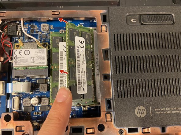

  3. HP Envy j-100 RAM Replacement, RAM Removal: crwdns2935265:03crwdnd2935265:01crwdnd2935265:02crwdne2935265:0 HP Envy j-100 RAM Replacement, RAM Removal: crwdns2935265:03crwdnd2935265:02crwdnd2935265:02crwdne2935265:0
    • Push the 2 clips out gently to pop the SODIMM up.
    • Pull the SODIMM out of the socket.
  4. HP Envy j-100 RAM Replacement, RAM Insertion: crwdns2935265:04crwdnd2935265:01crwdnd2935265:01crwdne2935265:0
    • Insert as shown in the diagram.
    • Make sure the SODIMM is fully inserted before laying it flat.
    • Make sure its fully inserted, or try a different SODIMM
    • Make sure the ram is DDR3L
