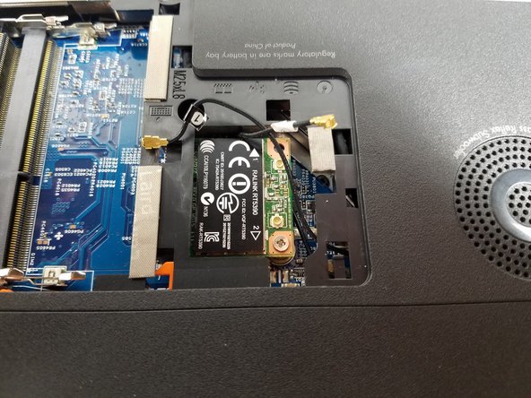

  6. HP Envy dv6-7363cl Wi-fi Card Replacement: crwdns2935265:06crwdnd2935265:01crwdnd2935265:01crwdne2935265:0
    • With the back cover removed, locate the Wi-Fi card which is positioned next to the Beats logo.
  7. HP Envy dv6-7363cl Wi-fi Card Replacement: crwdns2935265:07crwdnd2935265:01crwdnd2935265:02crwdne2935265:0 HP Envy dv6-7363cl Wi-fi Card Replacement: crwdns2935265:07crwdnd2935265:02crwdnd2935265:02crwdne2935265:0
    • Carefully remove gold-headed, black wires from Wi-Fi card with tweezers.
  8. HP Envy dv6-7363cl Wi-fi Card Replacement: crwdns2935265:08crwdnd2935265:01crwdnd2935265:02crwdne2935265:0 HP Envy dv6-7363cl Wi-fi Card Replacement: crwdns2935265:08crwdnd2935265:02crwdnd2935265:02crwdne2935265:0
    • After removing wires, remove circled screws from card.
    • Note: Laptop shown only has one screw holding in Wi-Fi card. Some models may have both.

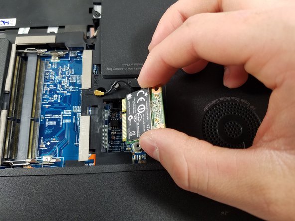

  9. HP Envy dv6-7363cl Wi-fi Card Replacement: crwdns2935265:09crwdnd2935265:01crwdnd2935265:02crwdne2935265:0 HP Envy dv6-7363cl Wi-fi Card Replacement: crwdns2935265:09crwdnd2935265:02crwdnd2935265:02crwdne2935265:0
    • Wi-Fi card will raise out of device when screw is removed.
    • Gently pull card to the right to remove from device.
