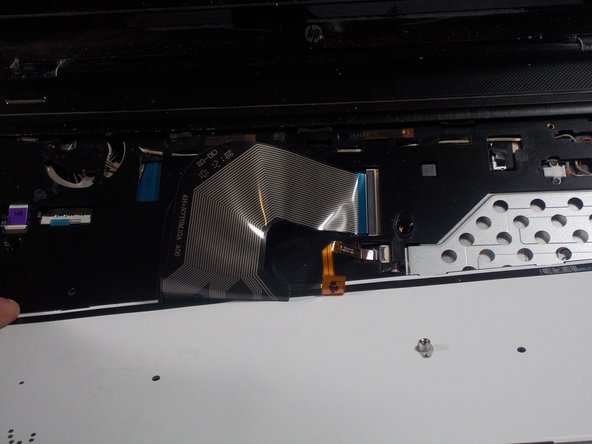

    • Start by opening the laptop
  2. HP Envy dv6-7363cl Keyboard Replacement: crwdns2935265:02crwdnd2935265:01crwdnd2935265:03crwdne2935265:0 HP Envy dv6-7363cl Keyboard Replacement: crwdns2935265:02crwdnd2935265:02crwdnd2935265:03crwdne2935265:0 HP Envy dv6-7363cl Keyboard Replacement: crwdns2935265:02crwdnd2935265:03crwdnd2935265:03crwdne2935265:0
    • Pry off the keyboard retainer slowly working your way around the board to prevent damage
  3. HP Envy dv6-7363cl Keyboard Replacement: crwdns2935265:03crwdnd2935265:01crwdnd2935265:02crwdne2935265:0 HP Envy dv6-7363cl Keyboard Replacement: crwdns2935265:03crwdnd2935265:02crwdnd2935265:02crwdne2935265:0
    • Carefully pull up on the key board there will be 2 ribbon strips holding it attached to the key board
  4. HP Envy dv6-7363cl Keyboard Replacement: crwdns2935265:04crwdnd2935265:01crwdnd2935265:02crwdne2935265:0 HP Envy dv6-7363cl Keyboard Replacement: crwdns2935265:04crwdnd2935265:02crwdnd2935265:02crwdne2935265:0
    • Pull up on the two grey tabs that hold the ribbon cable into the connector. Then remove the keyboard.
