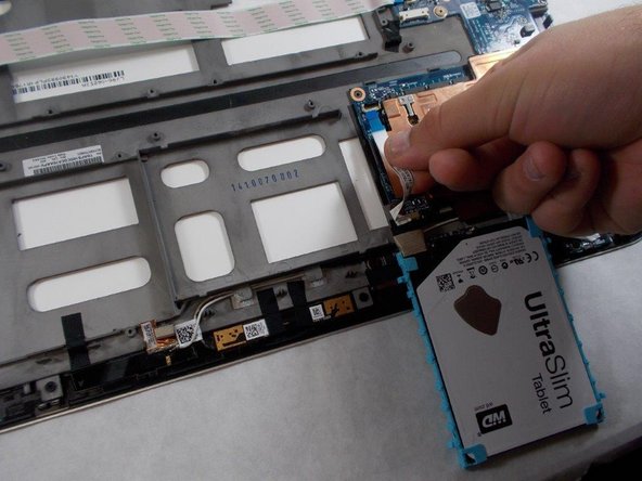

  11. HP Envy X2-15-C001Dx Hard Drive Replacement, Hard Drive: crwdns2935265:011crwdnd2935265:01crwdnd2935265:03crwdne2935265:0 HP Envy X2-15-C001Dx Hard Drive Replacement, Hard Drive: crwdns2935265:011crwdnd2935265:02crwdnd2935265:03crwdne2935265:0 HP Envy X2-15-C001Dx Hard Drive Replacement, Hard Drive: crwdns2935265:011crwdnd2935265:03crwdnd2935265:03crwdne2935265:0
    • Lift the hard drive out from its slot, taking care not to tear the ribbon cable that is connecting it to the motherboard.
    • Unplug the hard drive from the motherboard.
    • Completely remove the hard drive from the laptop.
