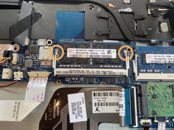

  6. HP Envy Ultrabook 4-1043cl RAM Replacement, RAM: crwdns2935265:06crwdnd2935265:01crwdnd2935265:03crwdne2935265:0 HP Envy Ultrabook 4-1043cl RAM Replacement, RAM: crwdns2935265:06crwdnd2935265:02crwdnd2935265:03crwdne2935265:0 HP Envy Ultrabook 4-1043cl RAM Replacement, RAM: crwdns2935265:06crwdnd2935265:03crwdnd2935265:03crwdne2935265:0
    • The RAM lies in the middle-right side of the device.
    • Use your fingers and push the two clips outwards to release the RAM stick.

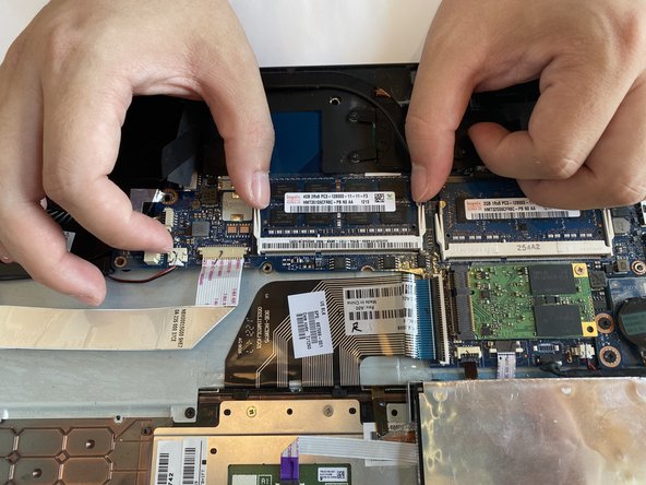

  7. HP Envy Ultrabook 4-1043cl RAM Replacement: crwdns2935265:07crwdnd2935265:01crwdnd2935265:01crwdne2935265:0
    • Remove the RAM from the device.
