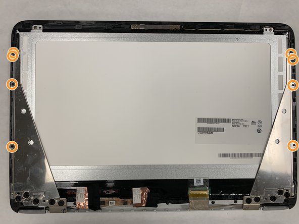

    • Remove the front panel from the rest of the device and set it aside.
    • Remove the ten M2.5x2.5 screws with the J0 screwdriver.
    • Remove the eight M2.0x2.0 screws with the J0 screwdriver.

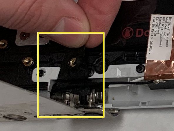

    • Flip hinges down and away from the rest of the panel.
    • Remove the four M2.5x2.5 screws with the J0 screwdriver.

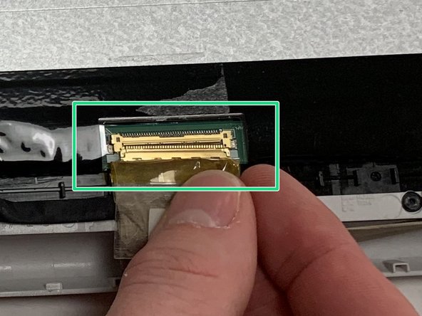

    • Move 4 pieces of black tape across the bottom of the panel and any other accessory tape.
    • Disconnect the display cable connector that is located at the bottom right of the panel by pulling lightly.
  5. HP Envy Touchsmart m6-k125dx Touch Screen Replacement: crwdns2935265:05crwdnd2935265:01crwdnd2935265:01crwdne2935265:0
    • Slowly lift the screen away from the touch screen front panel to remove.
