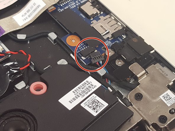

  3. HP Envy Touchsmart m6-k125dx Speaker Replacement, Speaker: crwdns2935265:03crwdnd2935265:01crwdnd2935265:01crwdne2935265:0
    • First, using a Phillips Head screwdriver, unscrew the two Phillips PM 2.5x5.5 screws that are connecting the speaker to the rest of the laptop.
  4. HP Envy Touchsmart m6-k125dx Speaker Replacement: crwdns2935265:04crwdnd2935265:01crwdnd2935265:02crwdne2935265:0 HP Envy Touchsmart m6-k125dx Speaker Replacement: crwdns2935265:04crwdnd2935265:02crwdnd2935265:02crwdne2935265:0
    • After unscrewing the screws, remove the speaker and carefully unplug it from the laptop.
