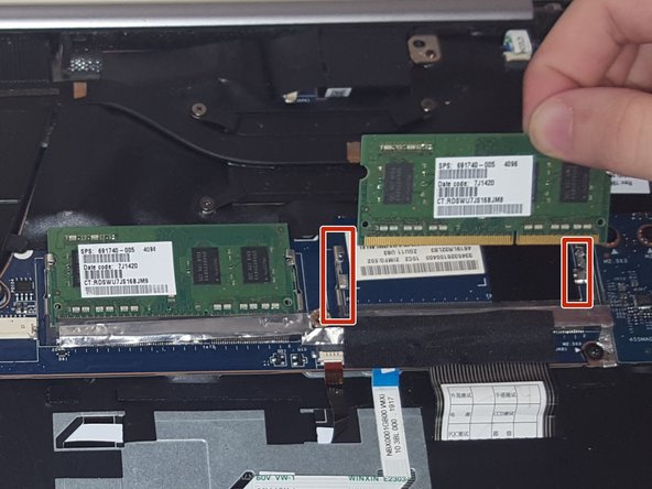

  3. HP Envy Touchsmart m6-k125dx RAM Replacement, RAM: crwdns2935265:03crwdnd2935265:01crwdnd2935265:01crwdne2935265:0
    • Locate both of the RAM devices and choose which one will be replaced.
  4. HP Envy Touchsmart m6-k125dx RAM Replacement: crwdns2935265:04crwdnd2935265:01crwdnd2935265:02crwdne2935265:0 HP Envy Touchsmart m6-k125dx RAM Replacement: crwdns2935265:04crwdnd2935265:02crwdnd2935265:02crwdne2935265:0
    • Gently remove the RAM by pressing against the side clamps of the connector holding it in place.
