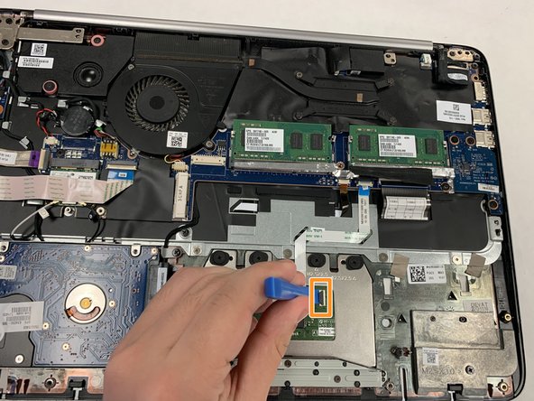

  3. HP Envy Touchsmart m6-k125dx Mouse Touch Pad Replacement, Mouse Touch Pad: crwdns2935265:03crwdnd2935265:01crwdnd2935265:02crwdne2935265:0 HP Envy Touchsmart m6-k125dx Mouse Touch Pad Replacement, Mouse Touch Pad: crwdns2935265:03crwdnd2935265:02crwdnd2935265:02crwdne2935265:0
    • The mouse touch pad is located in the bottom middle section of the back of the laptop.
    • Lift the black ZIF tab and gently pull the ribbon cable free.
  4. HP Envy Touchsmart m6-k125dx Mouse Touch Pad Replacement: crwdns2935265:04crwdnd2935265:01crwdnd2935265:01crwdne2935265:0
    • There are four M2.5X2.5 screws that need to be removed in order to take the mouse touch pad out.
    • Unscrew all four M2.5X2.5 screws with a JIS #0 screwdriver.
  5. HP Envy Touchsmart m6-k125dx Mouse Touch Pad Replacement: crwdns2935265:05crwdnd2935265:01crwdnd2935265:01crwdne2935265:0
    • Flip the laptop over and open it.
    • Gently press on the two top corners of the mouse touch pad, snapping it down and out.
    • Remove through the bottom of the laptop and replace.
