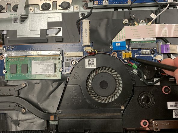

  3. HP Envy Touchsmart m6-k125dx Motherboard Replacement, Cooling Fan: crwdns2935265:03crwdnd2935265:01crwdnd2935265:02crwdne2935265:0 HP Envy Touchsmart m6-k125dx Motherboard Replacement, Cooling Fan: crwdns2935265:03crwdnd2935265:02crwdnd2935265:02crwdne2935265:0
    • Use the J0 screwdriver to remove the two M2.0x3.0 screws holding in the cooling fan
  4. HP Envy Touchsmart m6-k125dx Motherboard Replacement: crwdns2935265:04crwdnd2935265:01crwdnd2935265:03crwdne2935265:0 HP Envy Touchsmart m6-k125dx Motherboard Replacement: crwdns2935265:04crwdnd2935265:02crwdnd2935265:03crwdne2935265:0 HP Envy Touchsmart m6-k125dx Motherboard Replacement: crwdns2935265:04crwdnd2935265:03crwdnd2935265:03crwdne2935265:0
    • Unplug the cord and carefully remove the cooling fan

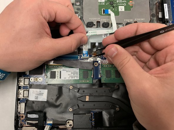

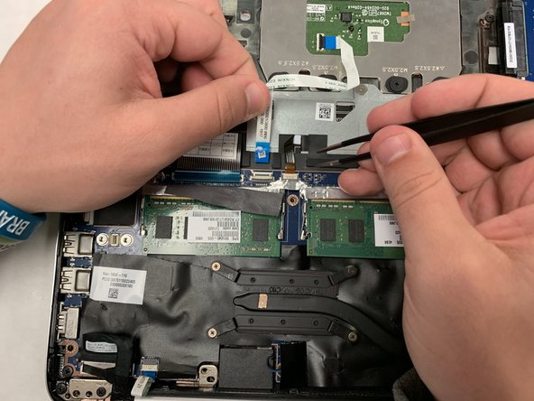

  6. HP Envy Touchsmart m6-k125dx Motherboard Replacement: crwdns2935265:06crwdnd2935265:01crwdnd2935265:03crwdne2935265:0 HP Envy Touchsmart m6-k125dx Motherboard Replacement: crwdns2935265:06crwdnd2935265:02crwdnd2935265:03crwdne2935265:0 HP Envy Touchsmart m6-k125dx Motherboard Replacement: crwdns2935265:06crwdnd2935265:03crwdnd2935265:03crwdne2935265:0
    • Disconnect the six ZIF connectors.
    • Use the tweezers to flip up the plastic retaining flap.
    • Pull the cable out horizontally.

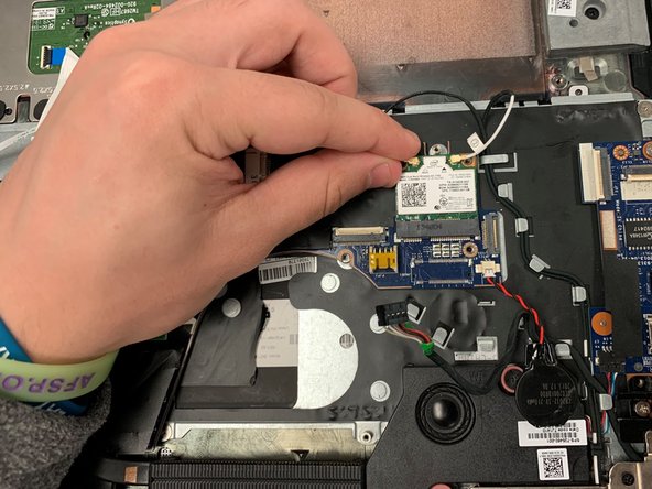

  8. HP Envy Touchsmart m6-k125dx Motherboard Replacement: crwdns2935265:08crwdnd2935265:01crwdnd2935265:02crwdne2935265:0 HP Envy Touchsmart m6-k125dx Motherboard Replacement: crwdns2935265:08crwdnd2935265:02crwdnd2935265:02crwdne2935265:0
    • Use the J0 screwdriver to remove the two M2.5x2.5 screws on the wireless network card.
    • Slide the card horizontally toward the front of the laptop and out of its socket.

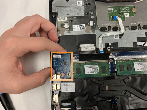

  9. HP Envy Touchsmart m6-k125dx Motherboard Replacement: crwdns2935265:09crwdnd2935265:01crwdnd2935265:01crwdne2935265:0
    • Use the J1 screwdriver to remove the four M2.5x2.5 screws that secure the motherboard to the case.
    • Pull up on the right side of the motherboard, away from the USB ports, then slide out to the right.
