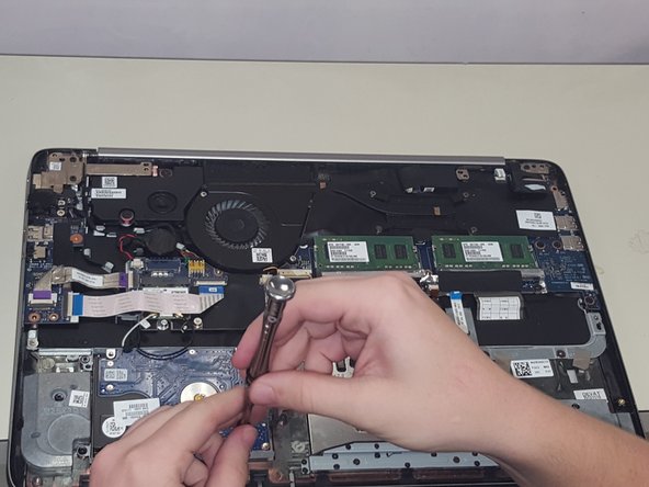

    • Turn the laptop over so that the bottom is facing up
    • Using the J0 screwdriver, unscrew all 12 M2.5x5.5 screws from the back panel.
  2. HP Envy Touchsmart m6-k125dx Hard Drive Replacement: crwdns2935265:02crwdnd2935265:01crwdnd2935265:01crwdne2935265:0
    • Carefully remove the back panel to reveal the inner components.

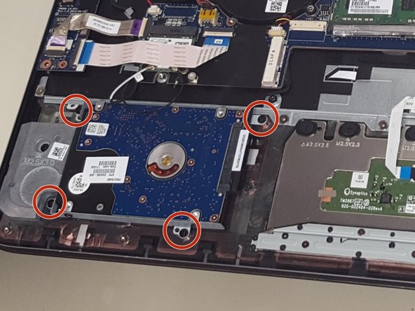

  3. HP Envy Touchsmart m6-k125dx Hard Drive Replacement, Hard Drive: crwdns2935265:03crwdnd2935265:01crwdnd2935265:03crwdne2935265:0 HP Envy Touchsmart m6-k125dx Hard Drive Replacement, Hard Drive: crwdns2935265:03crwdnd2935265:02crwdnd2935265:03crwdne2935265:0 HP Envy Touchsmart m6-k125dx Hard Drive Replacement, Hard Drive: crwdns2935265:03crwdnd2935265:03crwdnd2935265:03crwdne2935265:0
    • Using the JIS screwdriver along with the J000 head, unscrew the four Phillips PM2.5x5.5 screws, and place them aside.
  4. HP Envy Touchsmart m6-k125dx Hard Drive Replacement: crwdns2935265:04crwdnd2935265:01crwdnd2935265:01crwdne2935265:0
    • Carefully detach the Hard Drive Adapter, and remove the Hard Drive from the laptop.
    • Make sure not to pull from the cord; pull from the head of the adapter.
