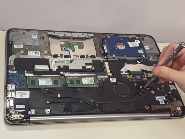

    • Turn the laptop over so that the bottom is facing up
    • Using the J0 screwdriver, unscrew all 12 M2.5x5.5 screws from the back panel.

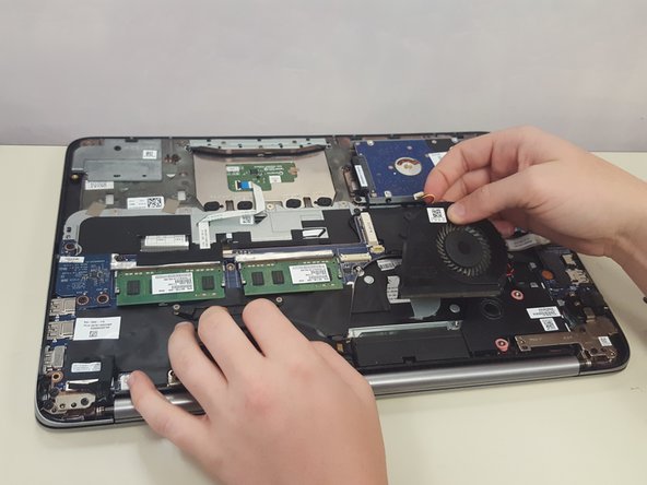

  2. HP Envy Touchsmart m6-k125dx Cooling Fan  Replacement: crwdns2935265:02crwdnd2935265:01crwdnd2935265:01crwdne2935265:0
    • Carefully remove the back panel to reveal the inner components.
  3. HP Envy Touchsmart m6-k125dx Cooling Fan  Replacement, Cooling Fan: crwdns2935265:03crwdnd2935265:01crwdnd2935265:02crwdne2935265:0 HP Envy Touchsmart m6-k125dx Cooling Fan  Replacement, Cooling Fan: crwdns2935265:03crwdnd2935265:02crwdnd2935265:02crwdne2935265:0
    • Use the J0 screwdriver to remove the two M2.0x3.0 screws holding in the cooling fan

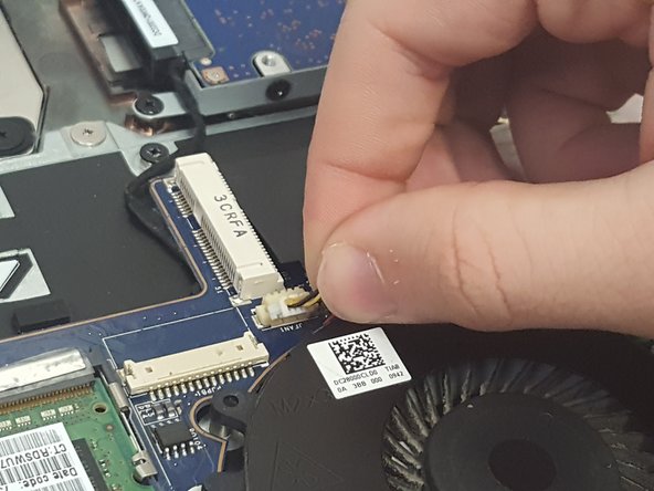

  4. HP Envy Touchsmart m6-k125dx Cooling Fan  Replacement: crwdns2935265:04crwdnd2935265:01crwdnd2935265:03crwdne2935265:0 HP Envy Touchsmart m6-k125dx Cooling Fan  Replacement: crwdns2935265:04crwdnd2935265:02crwdnd2935265:03crwdne2935265:0 HP Envy Touchsmart m6-k125dx Cooling Fan  Replacement: crwdns2935265:04crwdnd2935265:03crwdnd2935265:03crwdne2935265:0
    • Unplug the cord and carefully remove the cooling fan
