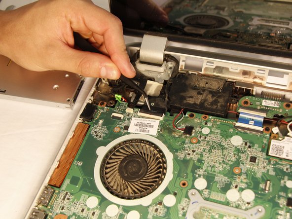

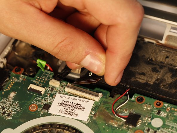

    • With tweezers in hand, begin by disengaging the tab on the upper left corner of the motherboard. Using your fingers, disconnect the plug that is to the left of the tab.

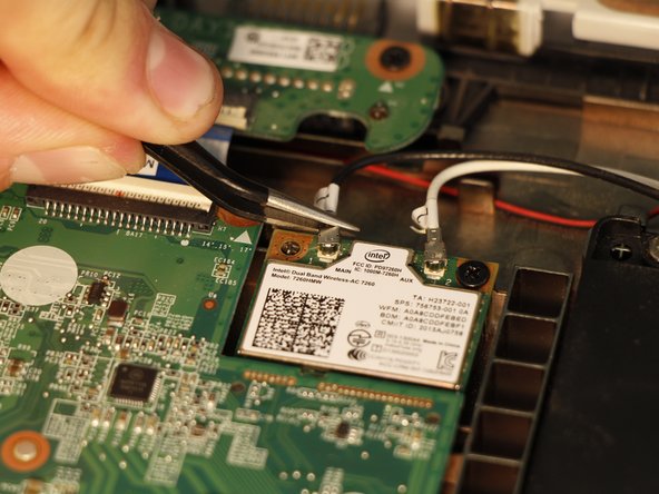

  13. HP Envy TouchSmart m7 k010dx Screen Replacement: crwdns2935265:013crwdnd2935265:01crwdnd2935265:03crwdne2935265:0 HP Envy TouchSmart m7 k010dx Screen Replacement: crwdns2935265:013crwdnd2935265:02crwdnd2935265:03crwdne2935265:0 HP Envy TouchSmart m7 k010dx Screen Replacement: crwdns2935265:013crwdnd2935265:03crwdnd2935265:03crwdne2935265:0

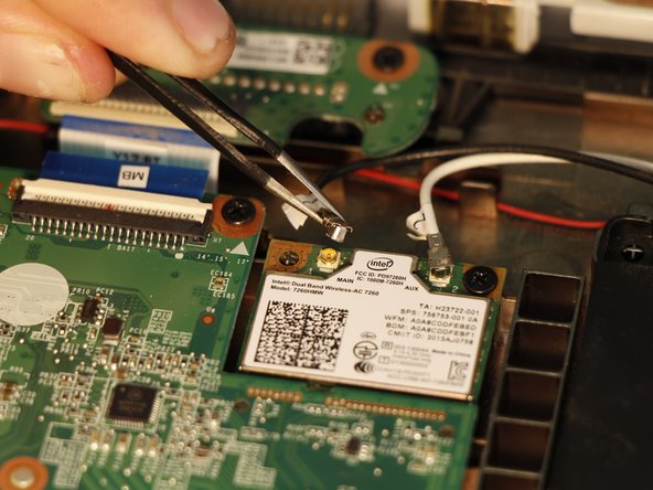

    • Using tweezers, gently remove the two cables connected to the WLAN module.

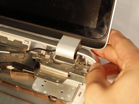

  14. HP Envy TouchSmart m7 k010dx Screen Replacement: crwdns2935265:014crwdnd2935265:01crwdnd2935265:03crwdne2935265:0 HP Envy TouchSmart m7 k010dx Screen Replacement: crwdns2935265:014crwdnd2935265:02crwdnd2935265:03crwdne2935265:0 HP Envy TouchSmart m7 k010dx Screen Replacement: crwdns2935265:014crwdnd2935265:03crwdnd2935265:03crwdne2935265:0

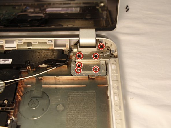

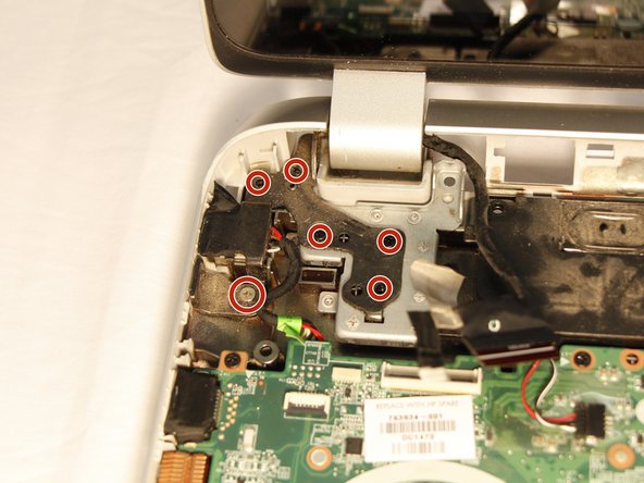

    • Using a JIS #00 screwdriver, remove the screws holding the hinges in place.
    • On the left hinge, there is a screw that does not appear to belong to hinge but is (circled in picture).

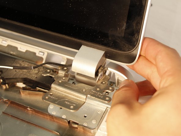

  15. HP Envy TouchSmart m7 k010dx Screen Replacement: crwdns2935265:015crwdnd2935265:01crwdnd2935265:03crwdne2935265:0 HP Envy TouchSmart m7 k010dx Screen Replacement: crwdns2935265:015crwdnd2935265:02crwdnd2935265:03crwdne2935265:0 HP Envy TouchSmart m7 k010dx Screen Replacement: crwdns2935265:015crwdnd2935265:03crwdnd2935265:03crwdne2935265:0

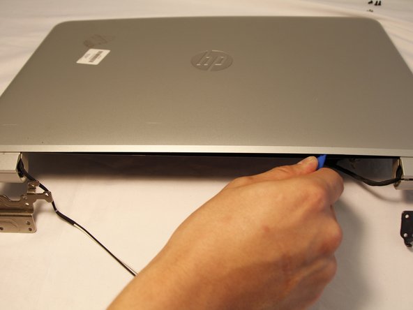

    • Remove the screen by pulling it forward from the casing. This allows the hinges to clear the casing.
  16. HP Envy TouchSmart m7 k010dx Screen Replacement: crwdns2935265:016crwdnd2935265:01crwdnd2935265:03crwdne2935265:0 HP Envy TouchSmart m7 k010dx Screen Replacement: crwdns2935265:016crwdnd2935265:02crwdnd2935265:03crwdne2935265:0 HP Envy TouchSmart m7 k010dx Screen Replacement: crwdns2935265:016crwdnd2935265:03crwdnd2935265:03crwdne2935265:0

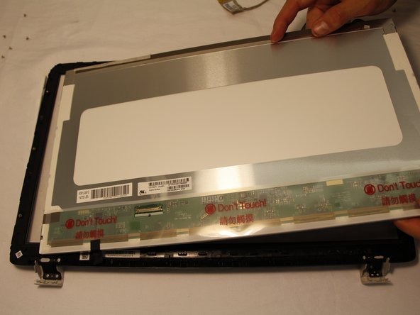

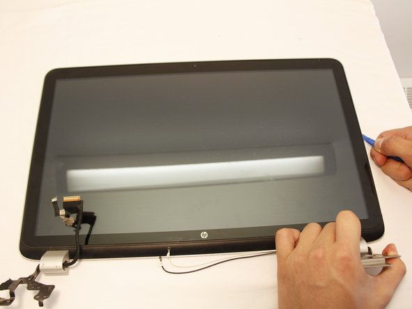

    • Use a plastic opening tool along the gap between the screen and the back panel to separate the two pieces.
    • When sliding with plastic opening tool, be careful around the webcam location to prevent damage.
  17. HP Envy TouchSmart m7 k010dx Screen Replacement: crwdns2935265:017crwdnd2935265:01crwdnd2935265:03crwdne2935265:0 HP Envy TouchSmart m7 k010dx Screen Replacement: crwdns2935265:017crwdnd2935265:02crwdnd2935265:03crwdne2935265:0 HP Envy TouchSmart m7 k010dx Screen Replacement: crwdns2935265:017crwdnd2935265:03crwdnd2935265:03crwdne2935265:0

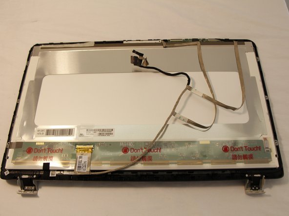

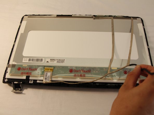

    • Carefully separate the display unit from its back panel.
    • There is glue between the two pieces, make sure you move slowly.
    • Flip the display unit over. Slowly remove the output cable from clips holding it in place.
    • To remove the two strip running to top of display simply lift to loosen the tack glue holding them in place.

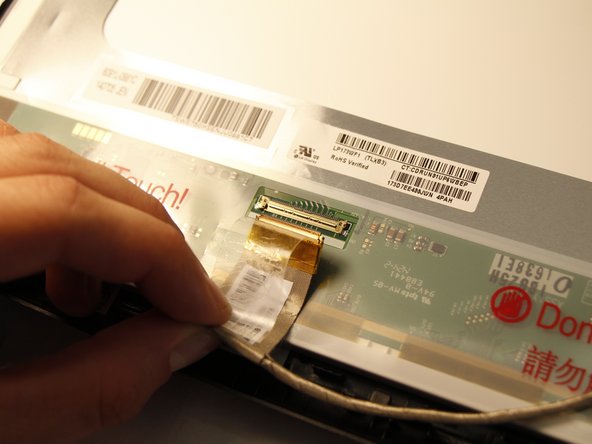

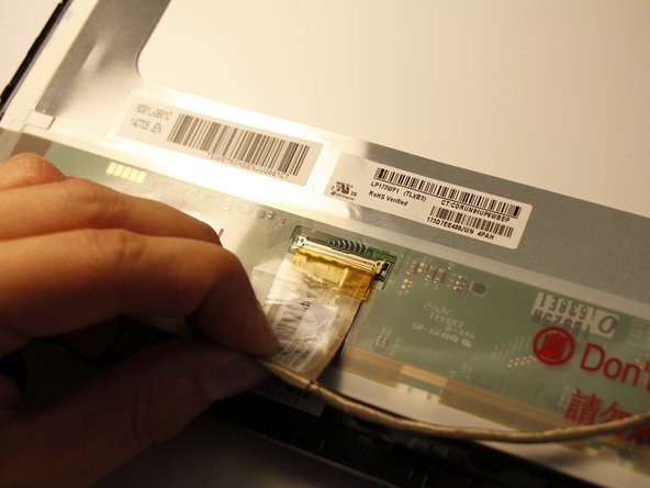

  18. HP Envy TouchSmart m7 k010dx Screen Replacement: crwdns2935265:018crwdnd2935265:01crwdnd2935265:03crwdne2935265:0 HP Envy TouchSmart m7 k010dx Screen Replacement: crwdns2935265:018crwdnd2935265:02crwdnd2935265:03crwdne2935265:0 HP Envy TouchSmart m7 k010dx Screen Replacement: crwdns2935265:018crwdnd2935265:03crwdnd2935265:03crwdne2935265:0
    • Use the spudger or your finger to remove the tape on the output connection.
    • Slowly and carefully pull the cable out from the connection.
    • Permanent damage can be caused on your computer if you pull the cable too hard.

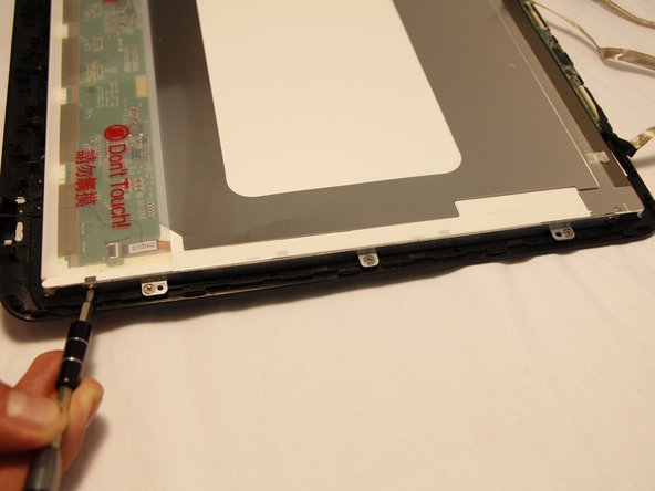

  19. HP Envy TouchSmart m7 k010dx Screen Replacement: crwdns2935265:019crwdnd2935265:01crwdnd2935265:03crwdne2935265:0 HP Envy TouchSmart m7 k010dx Screen Replacement: crwdns2935265:019crwdnd2935265:02crwdnd2935265:03crwdne2935265:0 HP Envy TouchSmart m7 k010dx Screen Replacement: crwdns2935265:019crwdnd2935265:03crwdnd2935265:03crwdne2935265:0
    • To remove the screen from its bezel there are a total of 4 Phillips head screws. 2 on left and 2 on right of the display unit.
    • Use a Phillips #0 screwdriver to remove the screws.
    • The display unit can now be taken out freely.
