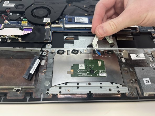

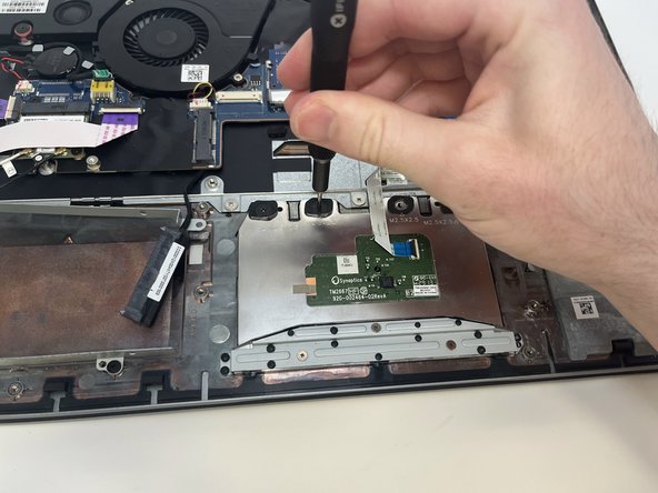

    • Use the screwdriver to remove the four 2 mm screws that secure the touchpad.
  6. HP Envy TouchSmart m6-k025dx Sleekbook Touchpad Replacement: crwdns2935265:06crwdnd2935265:01crwdnd2935265:02crwdne2935265:0 HP Envy TouchSmart m6-k025dx Sleekbook Touchpad Replacement: crwdns2935265:06crwdnd2935265:02crwdnd2935265:02crwdne2935265:0

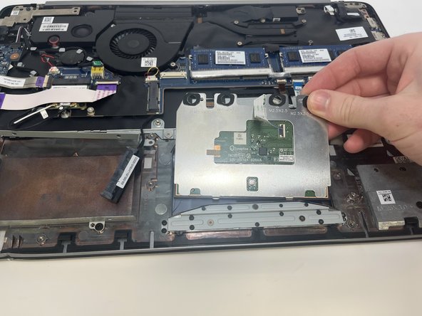

    • Once the screws have been removed, carefully pull the piece of blue tape away from the touchpad.
  7. HP Envy TouchSmart m6-k025dx Sleekbook Touchpad Replacement: crwdns2935265:07crwdnd2935265:01crwdnd2935265:02crwdne2935265:0 HP Envy TouchSmart m6-k025dx Sleekbook Touchpad Replacement: crwdns2935265:07crwdnd2935265:02crwdnd2935265:02crwdne2935265:0
    • Grab the touchpad piece from the top corner, and begin to pull it up and out to remove it from the laptop.
