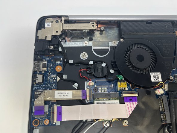

    • Flip the laptop over so that the backside of the laptop is facing upwards.
    • Use the Phillips #0 screwdriver to remove the twelve 5 mm screws that secure the bottom cover.
    • Insert a plastic opening tool into the opening between the bottom and top cover. Gently work your way around the perimeter of the case, and pry the two halves apart until the back cover is free from the laptop.

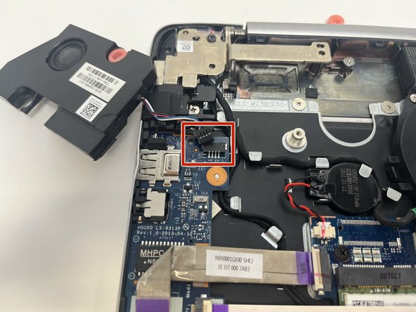

    • Remove the two 2 mm screws that secure the speaker.
  3. HP Envy TouchSmart m6-k025dx Sleekbook Speaker Replacement: crwdns2935265:03crwdnd2935265:01crwdnd2935265:03crwdne2935265:0 HP Envy TouchSmart m6-k025dx Sleekbook Speaker Replacement: crwdns2935265:03crwdnd2935265:02crwdnd2935265:03crwdne2935265:0 HP Envy TouchSmart m6-k025dx Sleekbook Speaker Replacement: crwdns2935265:03crwdnd2935265:03crwdnd2935265:03crwdne2935265:0
    • Using the tweezers, pull the black clip that is attached to the wires.
    • Pull the black connector completely free from the laptop, and remove the speaker.
