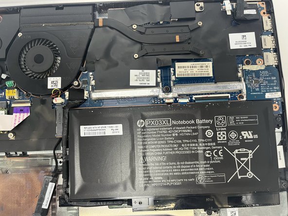

    • Flip the laptop over so that the backside of the laptop is facing upwards.
    • Remove the twelve 5 mm screws that hold the back cover in place.
    • Insert a plastic opening tool into the opening between the bottom and top cover. Gently work your way around the perimeter of the case, and pry the two halves apart until the back cover is free from the laptop.
  2. HP Envy TouchSmart m6-k025dx Sleekbook RAM Replacement: crwdns2935265:02crwdnd2935265:01crwdnd2935265:02crwdne2935265:0 HP Envy TouchSmart m6-k025dx Sleekbook RAM Replacement: crwdns2935265:02crwdnd2935265:02crwdnd2935265:02crwdne2935265:0

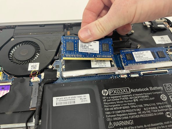

    • Identify the location of the RAM in the right-hand side of the laptop. For this device, it will be located above the battery.

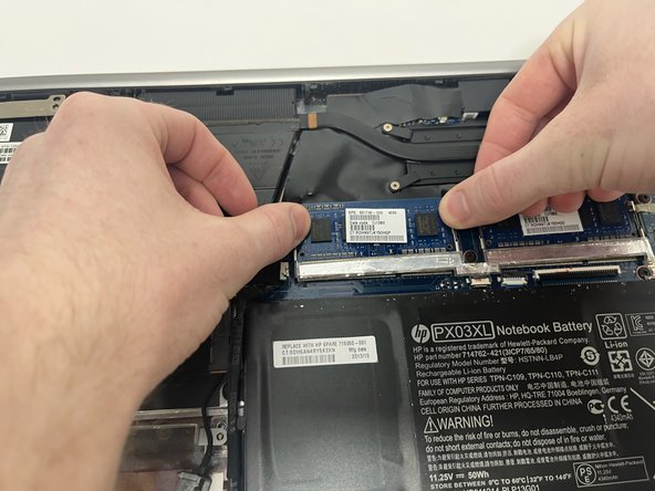

    • Gently press on the clips located on either side of the RAM stick.
    • Press downward on the clips until you feel the RAM stick start to come loose.
    • Do not try to pull the chip out without moving the clips first. This could potentially damage them.
    • The RAM stick will pop out. Carefully pull it free to remove it from the laptop.

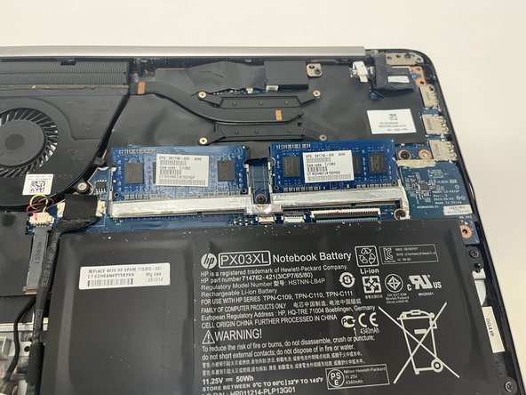

  4. HP Envy TouchSmart m6-k025dx Sleekbook RAM Replacement: crwdns2935265:04crwdnd2935265:01crwdnd2935265:03crwdne2935265:0 HP Envy TouchSmart m6-k025dx Sleekbook RAM Replacement: crwdns2935265:04crwdnd2935265:02crwdnd2935265:03crwdne2935265:0 HP Envy TouchSmart m6-k025dx Sleekbook RAM Replacement: crwdns2935265:04crwdnd2935265:03crwdnd2935265:03crwdne2935265:0
    • If desired, repeat the steps on the other chip, and gently pull it free from the laptop.
