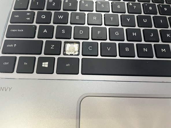

    • Open your laptop screen and orient the laptop so that the screen is facing you.
    • Identify which key on the keyboard needs replacement.
  2. HP Envy TouchSmart m6-k025dx Sleekbook Key Replacement: crwdns2935265:02crwdnd2935265:01crwdnd2935265:02crwdne2935265:0 HP Envy TouchSmart m6-k025dx Sleekbook Key Replacement: crwdns2935265:02crwdnd2935265:02crwdnd2935265:02crwdne2935265:0
    • Insert the flat end of the Jimmy tool underneath one side of the key. You may also use any other tool that can fit underneath the key cover.
    • Begin to carefully push at an upward angle in order to remove the black key cover.
  3. HP Envy TouchSmart m6-k025dx Sleekbook Key Replacement: crwdns2935265:03crwdnd2935265:01crwdnd2935265:02crwdne2935265:0 HP Envy TouchSmart m6-k025dx Sleekbook Key Replacement: crwdns2935265:03crwdnd2935265:02crwdnd2935265:02crwdne2935265:0
    • Once the black key cover is removed, you will notice that there is a plastic white piece composed of two parts.
    • Be careful not to try to remove the silicone piece that is found here. This part is glued into the laptop, and will result in damaged keys if broken.

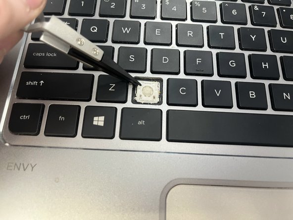

    • Using the tweezers, begin to pull the white plastic piece away from the keyboard.
  4. HP Envy TouchSmart m6-k025dx Sleekbook Key Replacement: crwdns2935265:04crwdnd2935265:01crwdnd2935265:02crwdne2935265:0 HP Envy TouchSmart m6-k025dx Sleekbook Key Replacement: crwdns2935265:04crwdnd2935265:02crwdnd2935265:02crwdne2935265:0
    • Remove the white plastic piece from the keyboard, ensuring that the two parts stay together.
