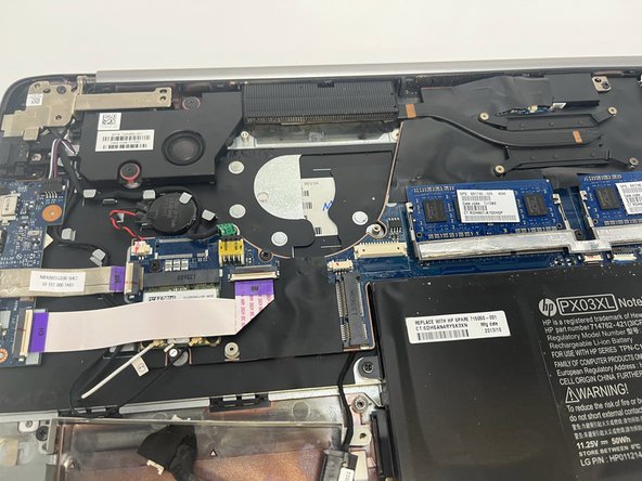

    • Flip the laptop over so that the backside of the laptop is facing upwards.
    • Use the Phillips #0 screwdriver to remove the twelve 5 mm screws that secure the bottom cover.
    • Insert a plastic opening tool into the opening between the bottom and top cover. Gently work your way around the perimeter of the case, and pry the two halves apart until the back cover is free from the laptop.
  2. HP Envy TouchSmart m6-k025dx Sleekbook Internal Cooling Fan Replacement: crwdns2935265:02crwdnd2935265:01crwdnd2935265:02crwdne2935265:0 HP Envy TouchSmart m6-k025dx Sleekbook Internal Cooling Fan Replacement: crwdns2935265:02crwdnd2935265:02crwdnd2935265:02crwdne2935265:0
    • Remove the two 2 mm screws that secure the fan.

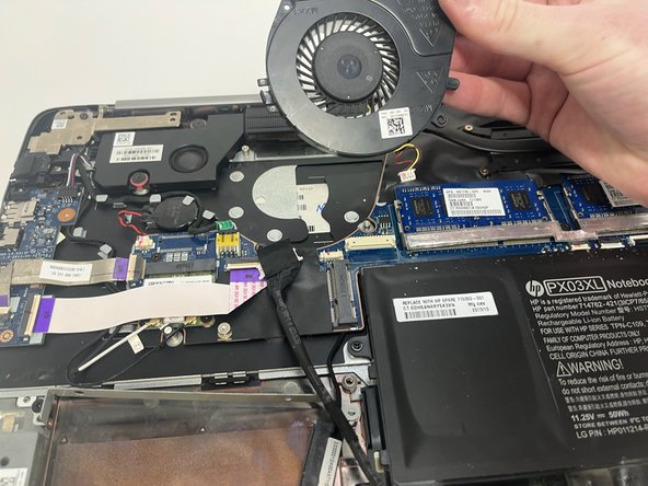

  3. HP Envy TouchSmart m6-k025dx Sleekbook Internal Cooling Fan Replacement: crwdns2935265:03crwdnd2935265:01crwdnd2935265:03crwdne2935265:0 HP Envy TouchSmart m6-k025dx Sleekbook Internal Cooling Fan Replacement: crwdns2935265:03crwdnd2935265:02crwdnd2935265:03crwdne2935265:0 HP Envy TouchSmart m6-k025dx Sleekbook Internal Cooling Fan Replacement: crwdns2935265:03crwdnd2935265:03crwdnd2935265:03crwdne2935265:0
    • Using tweezers, gently pull the fan's cable connector out of its socket.
    • Lift the fan off the motherboard to remove it completely.
