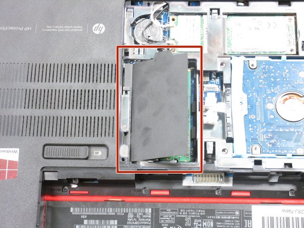

    • Press the battery release tab and the battery will pop up.
  2. HP Envy TouchSmart 15 RAM Replacement: crwdns2935265:02crwdnd2935265:01crwdnd2935265:01crwdne2935265:0
    • Remove the battery from the laptop, it will come out easily.
  3. HP Envy TouchSmart 15 RAM Replacement, Accessory Plate: crwdns2935265:03crwdnd2935265:01crwdnd2935265:02crwdne2935265:0 HP Envy TouchSmart 15 RAM Replacement, Accessory Plate: crwdns2935265:03crwdnd2935265:02crwdnd2935265:02crwdne2935265:0
    • Remove the single screw holding the accessory plate. This is a PH0 2.0x2.5 screw.
  4. HP Envy TouchSmart 15 RAM Replacement: crwdns2935265:04crwdnd2935265:01crwdnd2935265:03crwdne2935265:0 HP Envy TouchSmart 15 RAM Replacement: crwdns2935265:04crwdnd2935265:02crwdnd2935265:03crwdne2935265:0 HP Envy TouchSmart 15 RAM Replacement: crwdns2935265:04crwdnd2935265:03crwdnd2935265:03crwdne2935265:0
    • Pry the accessory plate up from the back of the laptop by applying force upwards where the screw was removed.
  5. HP Envy TouchSmart 15 RAM Replacement, RAM: crwdns2935265:05crwdnd2935265:01crwdnd2935265:02crwdne2935265:0 HP Envy TouchSmart 15 RAM Replacement, RAM: crwdns2935265:05crwdnd2935265:02crwdnd2935265:02crwdne2935265:0
    • Hold back the covering to reveal the RAM modules.
  6. HP Envy TouchSmart 15 RAM Replacement: crwdns2935265:06crwdnd2935265:01crwdnd2935265:01crwdne2935265:0
    • Press the clips on the edges of the RAM modules outward to pop them out.
  7. HP Envy TouchSmart 15 RAM Replacement: crwdns2935265:07crwdnd2935265:01crwdnd2935265:03crwdne2935265:0 HP Envy TouchSmart 15 RAM Replacement: crwdns2935265:07crwdnd2935265:02crwdnd2935265:03crwdne2935265:0 HP Envy TouchSmart 15 RAM Replacement: crwdns2935265:07crwdnd2935265:03crwdnd2935265:03crwdne2935265:0
    • You can now remove the RAM modules you need to replace. You can replace the top one, the bottom one, or both if needed.
