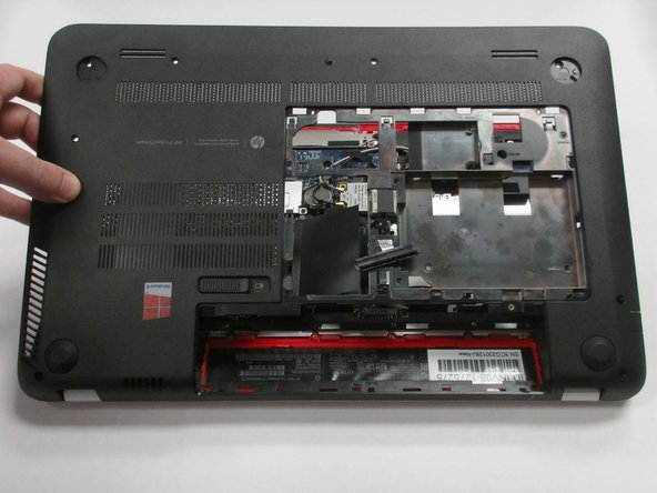

  3. HP Envy TouchSmart 15 Fan  Replacement, Accessory Plate: crwdns2935265:03crwdnd2935265:01crwdnd2935265:02crwdne2935265:0 HP Envy TouchSmart 15 Fan  Replacement, Accessory Plate: crwdns2935265:03crwdnd2935265:02crwdnd2935265:02crwdne2935265:0
    • Remove the single screw holding the accessory plate. This is a PH0 2.0x2.5 screw.
  4. HP Envy TouchSmart 15 Fan  Replacement: crwdns2935265:04crwdnd2935265:01crwdnd2935265:03crwdne2935265:0 HP Envy TouchSmart 15 Fan  Replacement: crwdns2935265:04crwdnd2935265:02crwdnd2935265:03crwdne2935265:0 HP Envy TouchSmart 15 Fan  Replacement: crwdns2935265:04crwdnd2935265:03crwdnd2935265:03crwdne2935265:0
    • Pry the accessory plate up from the back of the laptop by applying force upwards where the screw was removed.

  9. HP Envy TouchSmart 15 Fan  Replacement, Back Plate: crwdns2935265:09crwdnd2935265:01crwdnd2935265:03crwdne2935265:0 HP Envy TouchSmart 15 Fan  Replacement, Back Plate: crwdns2935265:09crwdnd2935265:02crwdnd2935265:03crwdne2935265:0 HP Envy TouchSmart 15 Fan  Replacement, Back Plate: crwdns2935265:09crwdnd2935265:03crwdnd2935265:03crwdne2935265:0
    • Remove the highlighted rubber stoppers with a metal spudger as pictured. They should expose a screw that you will need to remove in a later step.
  10. HP Envy TouchSmart 15 Fan  Replacement: crwdns2935265:010crwdnd2935265:01crwdnd2935265:03crwdne2935265:0 HP Envy TouchSmart 15 Fan  Replacement: crwdns2935265:010crwdnd2935265:02crwdnd2935265:03crwdne2935265:0 HP Envy TouchSmart 15 Fan  Replacement: crwdns2935265:010crwdnd2935265:03crwdnd2935265:03crwdne2935265:0
    • Remove plastic cover highlighted. It should expose a screw that you will need in a later step.

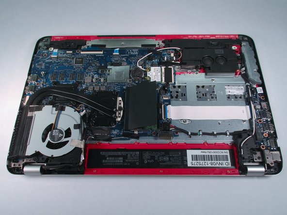

  14. HP Envy TouchSmart 15 Fan  Replacement: crwdns2935265:014crwdnd2935265:01crwdnd2935265:03crwdne2935265:0 HP Envy TouchSmart 15 Fan  Replacement: crwdns2935265:014crwdnd2935265:02crwdnd2935265:03crwdne2935265:0 HP Envy TouchSmart 15 Fan  Replacement: crwdns2935265:014crwdnd2935265:03crwdnd2935265:03crwdne2935265:0
    • Pry open back plate area with plastic opening tool. The back plate should pry open with relative ease. If you feel some resistance at any point please refer to steps 2-5 because a screw has probably been missed.

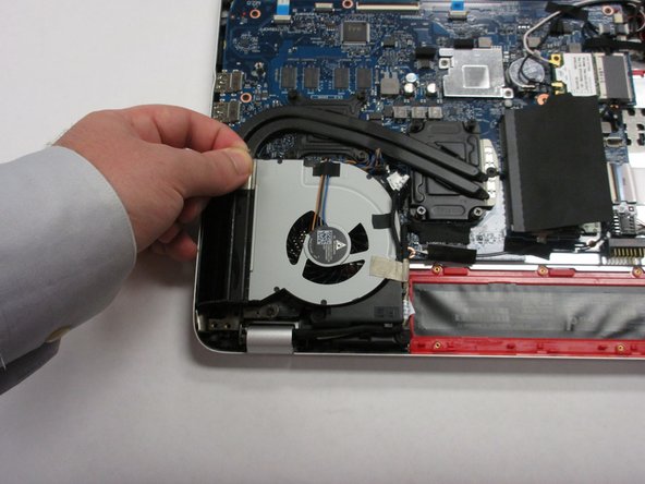

  15. HP Envy TouchSmart 15 Fan  Replacement, Fan: crwdns2935265:015crwdnd2935265:01crwdnd2935265:02crwdne2935265:0 HP Envy TouchSmart 15 Fan  Replacement, Fan: crwdns2935265:015crwdnd2935265:02crwdnd2935265:02crwdne2935265:0
    • There are 3 screws holding the fan in place. These are PM 2.5x4.5 screws
  16. HP Envy TouchSmart 15 Fan  Replacement: crwdns2935265:016crwdnd2935265:01crwdnd2935265:02crwdne2935265:0 HP Envy TouchSmart 15 Fan  Replacement: crwdns2935265:016crwdnd2935265:02crwdnd2935265:02crwdne2935265:0
    • There are 3 strips of tape. Remove them with your hand.
  17. HP Envy TouchSmart 15 Fan  Replacement: crwdns2935265:017crwdnd2935265:01crwdnd2935265:01crwdne2935265:0
    • Remove the fan by sliding it out and pulling it upwards. Set the fan off to the side to reveal the connector.
  18. HP Envy TouchSmart 15 Fan  Replacement: crwdns2935265:018crwdnd2935265:01crwdnd2935265:02crwdne2935265:0 HP Envy TouchSmart 15 Fan  Replacement: crwdns2935265:018crwdnd2935265:02crwdnd2935265:02crwdne2935265:0
    • Remove the black connector from the white insert shown at the center of the picture just below the fingers pinching the black connector.
    • The connector will come out straight up.
