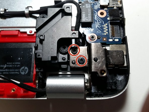

    • Remove the screws from each hinge.
    • Lift the hinges with pliers until they are perpendicular to the case.
    • Lift and remove the bottom of the laptop from the screen.
