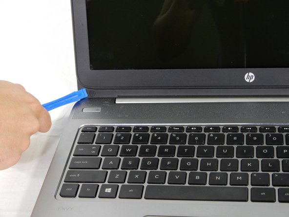

  6. HP Envy Sleekbook m6-k010dx LCD Replacement, LCD: crwdns2935265:06crwdnd2935265:01crwdnd2935265:02crwdne2935265:0 HP Envy Sleekbook m6-k010dx LCD Replacement, LCD: crwdns2935265:06crwdnd2935265:02crwdnd2935265:02crwdne2935265:0
    • Remove the stickers from the bottom left and right corner of the device with a plastic opening tool.
  7. HP Envy Sleekbook m6-k010dx LCD Replacement: crwdns2935265:07crwdnd2935265:01crwdnd2935265:01crwdne2935265:0
    • Remove the two 2.5mm Phillips #00 screws found underneath the previously removed stickers.

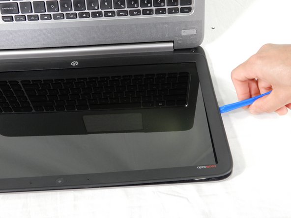

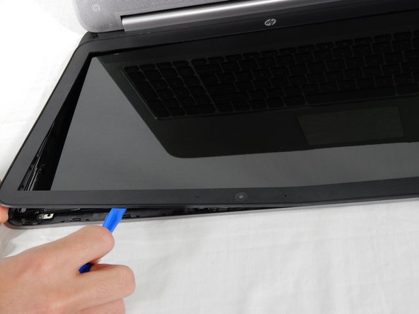

  8. HP Envy Sleekbook m6-k010dx LCD Replacement: crwdns2935265:08crwdnd2935265:01crwdnd2935265:03crwdne2935265:0 HP Envy Sleekbook m6-k010dx LCD Replacement: crwdns2935265:08crwdnd2935265:02crwdnd2935265:03crwdne2935265:0 HP Envy Sleekbook m6-k010dx LCD Replacement: crwdns2935265:08crwdnd2935265:03crwdnd2935265:03crwdne2935265:0
    • Use the plastic opening tool to pry the bezel free from the LCD housing.

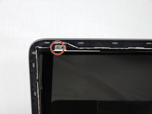

  9. HP Envy Sleekbook m6-k010dx LCD Replacement: crwdns2935265:09crwdnd2935265:01crwdnd2935265:02crwdne2935265:0 HP Envy Sleekbook m6-k010dx LCD Replacement: crwdns2935265:09crwdnd2935265:02crwdnd2935265:02crwdne2935265:0
    • Remove the four 2.5mm Phillips #00 screws located in each corner of the LCD screen.
