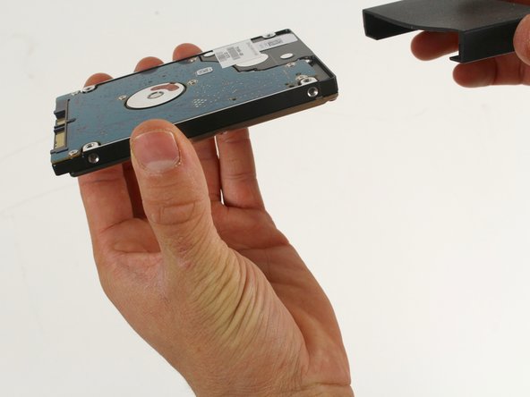

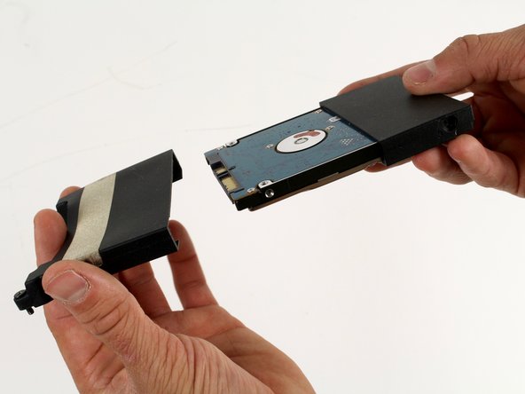

  12. HP Envy Rove 20-k014us Hard Drive from Case Replacement, Hard Drive from Case: crwdns2935265:012crwdnd2935265:01crwdnd2935265:03crwdne2935265:0 HP Envy Rove 20-k014us Hard Drive from Case Replacement, Hard Drive from Case: crwdns2935265:012crwdnd2935265:02crwdnd2935265:03crwdne2935265:0 HP Envy Rove 20-k014us Hard Drive from Case Replacement, Hard Drive from Case: crwdns2935265:012crwdnd2935265:03crwdnd2935265:03crwdne2935265:0
    • Remove four 3.5 mm PH#0 screws on the sides of the hard drive.
  13. HP Envy Rove 20-k014us Hard Drive from Case Replacement: crwdns2935265:013crwdnd2935265:01crwdnd2935265:03crwdne2935265:0 HP Envy Rove 20-k014us Hard Drive from Case Replacement: crwdns2935265:013crwdnd2935265:02crwdnd2935265:03crwdne2935265:0 HP Envy Rove 20-k014us Hard Drive from Case Replacement: crwdns2935265:013crwdnd2935265:03crwdnd2935265:03crwdne2935265:0
    • Slide black rubber case off the hard drive.
    • When replacing the screws around the case, don't cinch them too hard; just secure the rubber case to the hard drive.
